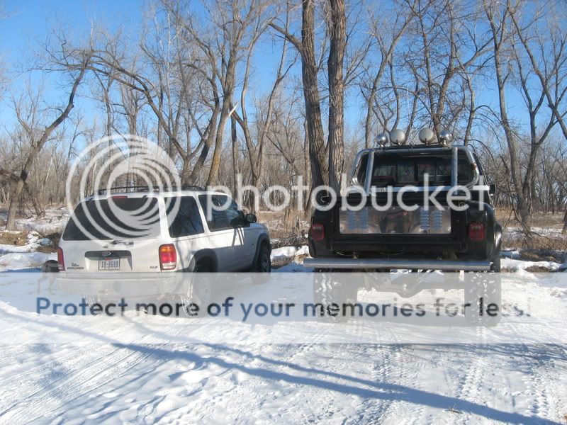

Well im finally getting back into cbs. I have two cheap antennas on my truck and they dont get out worth a crap:angry: I was wanting to get a monkey made but this is what im working with..
its about 8 ft to the top of the lights and dont want something thats going to snap off when i go off roading. Im was told to put the antenna onto of the roll bar for best performance. Now im just wanting an antenna that will do the job... Am planning on running close to 1,000 watts at some point in time and would just like a second opinion.. Mabey a wilson?
