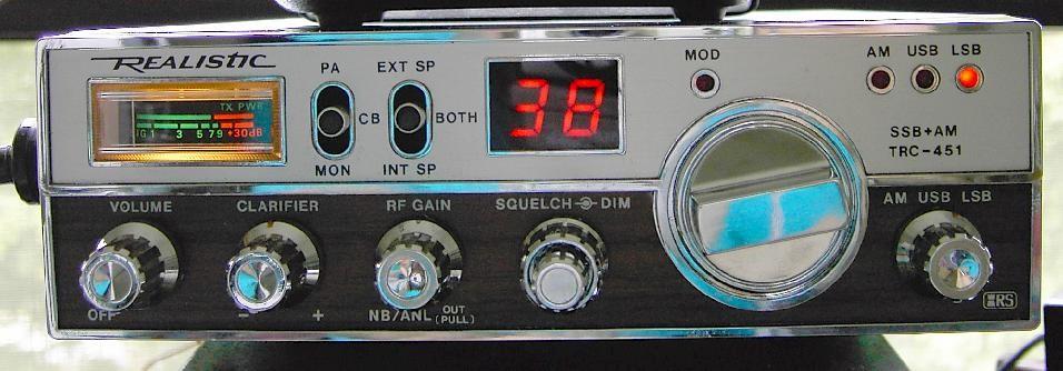

I currently use a realistic cb sideband radio a trc 451 that pushes about 20 watts on s/b and 11 watts on am. I use a magnetic mount wilson antenna "little wil". The antenna and radio set up work pretty well. The antenna new only cost $25.00 and has a pretty short whip. My question is, how much better performance could I expect from a better antenna such as the Wilson 1000 or 5000. They cost between $65-$85 so I assume they will work better but how much better. I dont know much about cb so any input will be helpfull. Thx

I personally think the lil Wil is OK for a road trip or just a quick fix so to speak , other then that , Wilson 1K or 5K is at least a 10 times better antenna period ! You want talk and receive 10 times better , the 1K or 5K will do that for you . I would never ever tell a guy to buy a lil Wil unless it was simply for car to car ops on a road trip. You don't believe me ? buy one and compare the two , NO CONTEST ! .....oh yeah .That TRC-451 is a very decent well made Uniden radio that deserves a better antenna then that Lil Wil )-:
