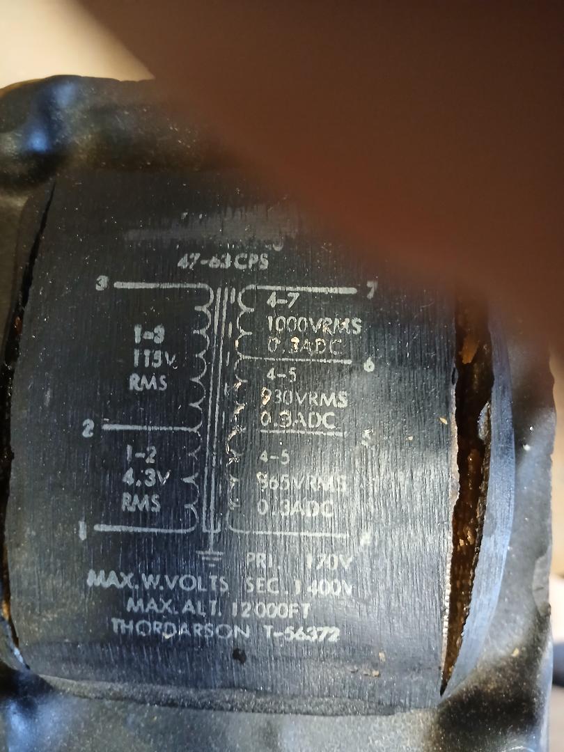

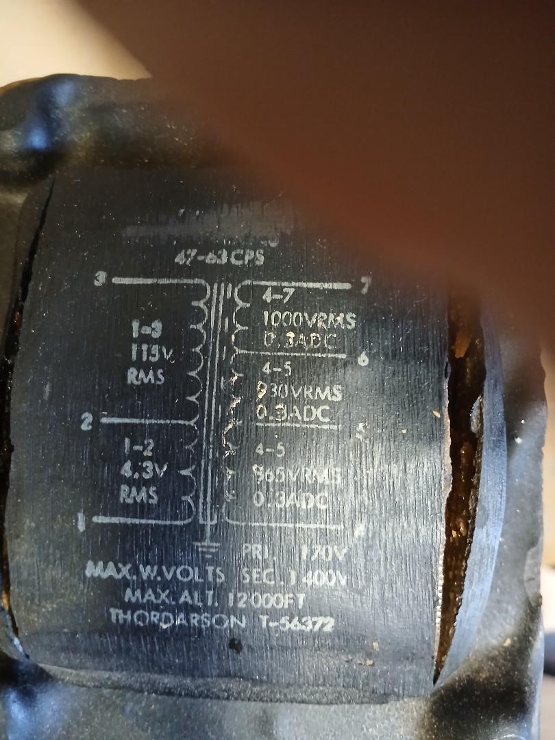

I have a Apollo 500 and the transformer is bad it is a 1300v can I replace it with 2 transformers out of a D&A Phantom they are around 850v i believe. Here is one from Apollo.
It appears that transformer has been operated above its maximum altitude of 12,000 feet... I'm assuming this amplifier runs sweep tubes and 900 to 1,000 volts AC before rectification and filtering, seems very high for sweep tubes. As I recall the D&A transformers are 660 volts AC. They work great with a full wave bridge rectifier on sweep tubes.I have a Apollo 500 and the transformer is bad it is a 1300v can I replace it with 2 transformers out of a D&A Phantom they are around 850v i believe. Here is one from Apollo.View attachment 70247
To answer your question: The change of a different transformer, will most likely require additional work, unless it is a direct replacement. (which the D&A's will not be) rectifier config/Cap configuration...possibly many more components and circuitry will need to be examined. IMHOI have a Apollo 500 and the transformer is bad it is a 1300v can I replace it with 2 transformers out of a D&A Phantom they are around 850v i believe. Here is one from Apollo.View attachment 70247
