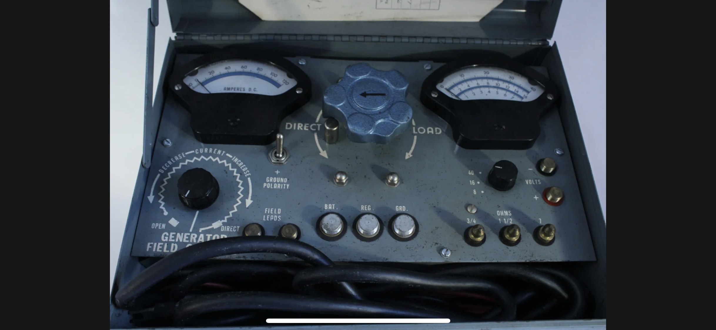

I have a Schumacher model mentioned above. It has worked well for what I have needed it for. But, I also have a few slightly bulky military generator test sets that you can do quite a bit with. They are technically portable, but best suited as having a spot in the garage if the need is great enough.
There are many variations of these, but they all do the same job. You can load test up to 500 amps if needed (if my memory serves) For some, it could be a good option.
