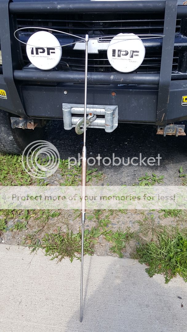

Not always the case. That's why I mentioned the Freightliner Cascadia since there are commercially made brackets and using a 102 whip will be about 5 ft. off the ground. That's just as high or higher off the ground than the typical 4 wheeler will have it.
The pic below is not a 102 whip but it's just to give a visual example to what I'm talking about.
Reactions: skip searcher
