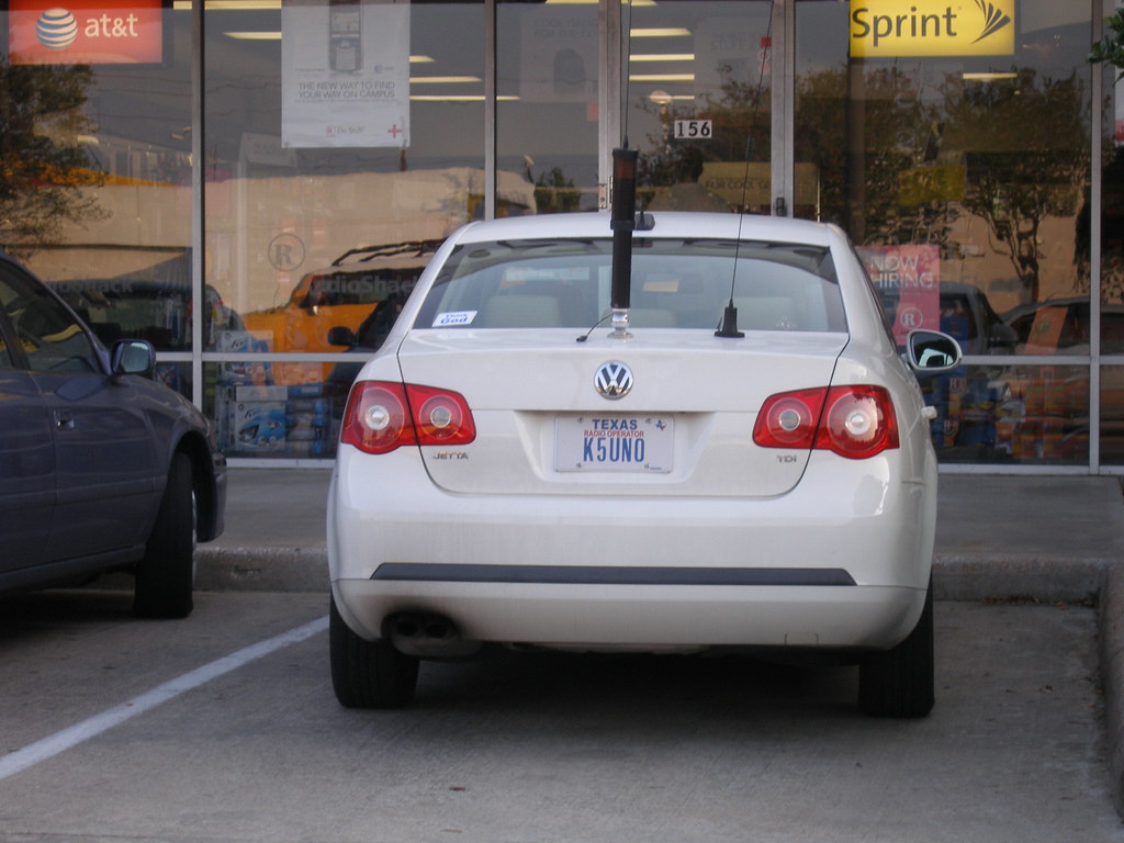

While not my exact setup this is simular to what I run -
