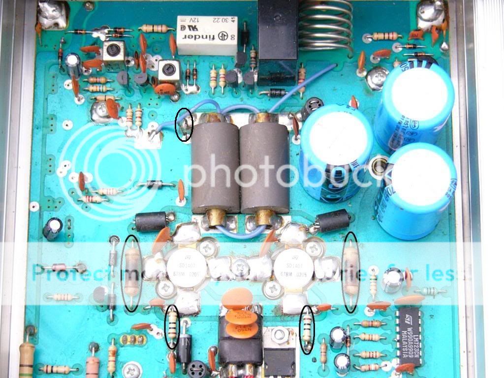

heres what happens on a stock klv550 if you listen to rm and input 10w fm,
i see rm amps MUCH more burned up than this one, fortunately this one was only ever run on pwr setting 6 so the input sellector resistors and board did not get fried,
http://i5.photobucket.com/albums/y152/ukmudduck/burnt feedback resistors/P1010207.jpg
you may think that if you input 10w and use a lower pwr setting on the amp that will protect the amp, not so, all you get is burned resistors on the pwr sellector board and 6 settings that all produce full power,
take rm's figures and half them, treat the ssb input rating as pep, you will be in the ballpark of what a stock klv550 will stand without burning components,
if the grant is stock output it will be about twice what a stock klv550 is happy with.
