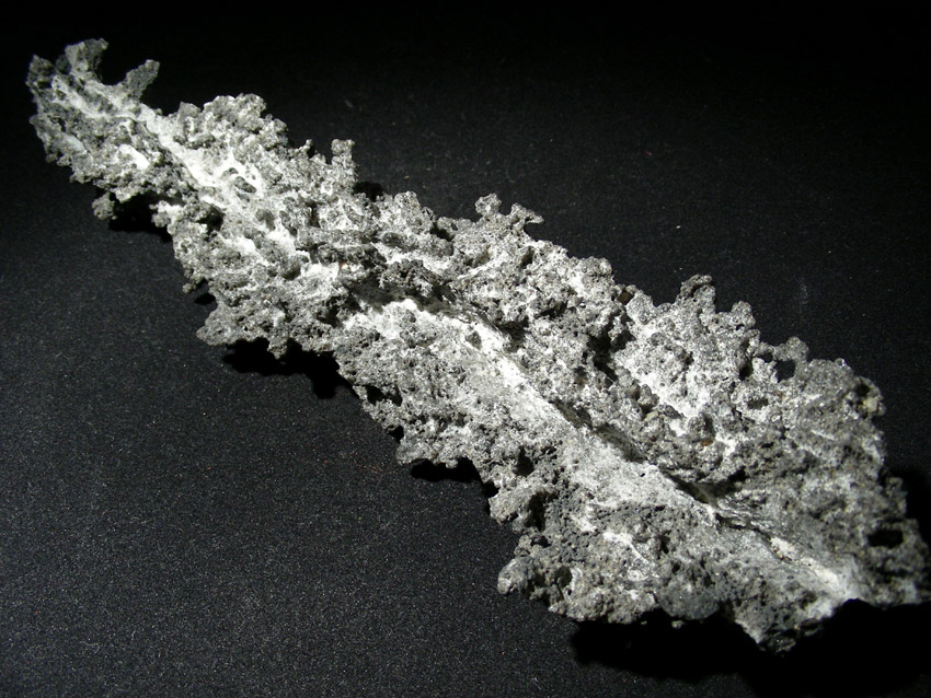

this is lightning glass dug from the earth.
