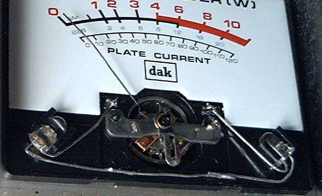

I just got me a Dak X and one of the meter lights is out. I ordered the lights, but have never changed them on a Dak. Can some provide instructions on how to change the light inside the meter please? Any help would be greatly appreciated... Dan
We use 5mm LEDs. The ballast resistor is in line with the hot wire feeding the lug on the rear of the meter.
