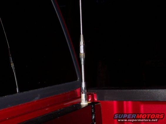

Finally decided to give the 102" a try, I used a wilson 5000 5" mast and a couple connectors. For a adjustable 108" It seems to work quite well, SWR is 1.2 on 1 and just moves the needle on the Vanco enough to say it moved but not enough for a reading on 40. Made a few local contacts but have not had the chance to see if there is an improvement over the P10k. I stole the idea from a local radio head friend and thought it was worth sharing. I will be moving it the the inside right rear bed rail but it will do for now where it is.
ive suggested trying that to several folks ..... good to see it tuned so well for you :)
be sure to update us on its tx and rx after youve had more time to evaluate it .
I did the same thing with a 12'' piece of all threaded rod and those wilson nuts on a 96'' fiberglass whip from an old shakespear bigstick and it worked fine as well.
Thanks guys, I can get almost 2" of adjustment from the wilson shaft but after messing with it a little I can't say it does much for tuning. Will I see an improvement moving it to the inside rear corner of the box or should I leave it as is?
Thanks
Tim
Thanks
Tim
I'd say if you have it mounted solid and you're seeing a good tune why mess with it unless you need the bed space?
I think youʻll get better SWR on the rear corner of the bed cause where you have it now, the cab is in the way. But a 1.2:1 SWR is good. Good luck, aloha, James....

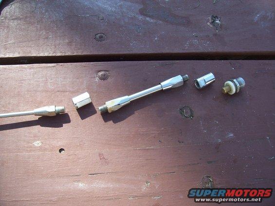

Here is the break down pic I mentioned. As far as rx-tx I can't honestly say I notice a difference between the P10K and the 102" Besides the 102" is much easier to tune (bolting it on is pretty easy) and I have no worrys about bumping a tree or the drive thru height bar. I do like the looks of it where it is mounted. The 10K made my truck look like a platform for an antenna where the 102" looks like a simple and effective antenna mounted on a truck. It's a keeper(y)
