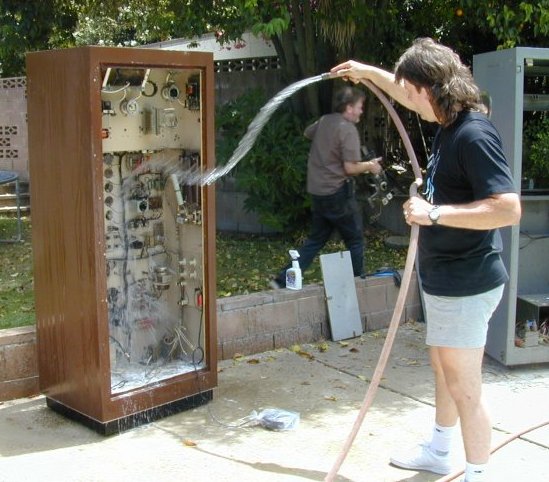

One ham that collected and modified tube type AM broadcast transmitters for use on 160/80/40 meters used to take out the heavy iron and hose them out with a garden hose or pressure washer. I wish I could find the website showing him taking it home and hosing it out. LOL I couldn't believe it until I saw for myself. It looked new when he finished.

Read my post again. I said he removed all "the heavy iron". The term "heavy iron" is used to mean transformers, modulation chokes and reactors as well as power supply chokes because in broadcast transmitters those things are HEAVY and made of iron. Old buzzard AM types would have caught that right off however some may not even know the term "old buzzard". LOL :D
It kind of freaked me out at first thought then I had another thought about and figured as long as the heavy iron was out of it why not. I'll try and find the site again if it even exists. IIRC it was a Gates BC1 series 1Kw AM transmitter just like one I used to service and that is what freaked me out the most I think.
As for electronics and liquids not mixing well, as long as the power is off and it contains no transformers or chokes and things dry out before it is powered up things should be fine.

Story here http://www.qsl.net/ve7khz/broadcast.html
