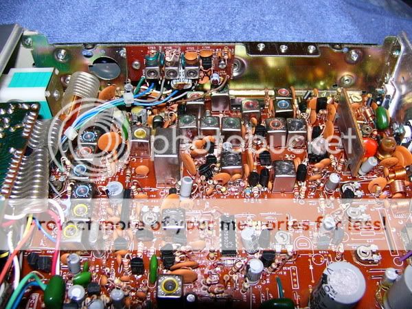

the 146 came after the 148 here, they came in 40 and 80ch versions and are a decent ssb radio but single conversion rx on am, it is hard to find one that sounds bad once it is aligned, this is a president ar144 i put highband on, it uses the same board as 146
looks like my uniden pc244 is the same as my uniden?i need to do some mods for this radio it does not swing much..does some one have any mods
look where my amc preset is set compared to youres lol, my am is set at 95% modulation :D
both of my 144's use nec d2824c pll chips, thats why i built the oscillator board for extra channels
