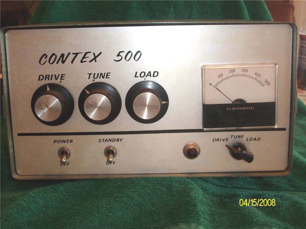

I just bought a Context 500 for use on 11 meters in my new little shack. Does anyone have a manual for this or know where I can get one? I am looking for information on the tuning procedure for setting the drive and the load etc. I assume it would be the same as any other amp? It has five 6LQ6 tubes and appears to be recapped. I don't have it in my hands yet, just trying to learn all I can about it. There is surprisingly little information about it when Googled. Any and all comments welcome.
This is not the actual unit, just a picture I found of one.

Doesn't have any fixed grid-bias voltage on the tubes. The tubes will tend to draw excess current with a low drive carrier level, or on sideband where there is no carrier.
The carrier from the radio serves to set the tubes' operating current. With zero bias, they will cherry up and smoke something.
The SSB switch on a lot of older sweep-tube amplifiers is a borderline fraud to begin with. Could easily be labeled "Suicide Selector".

That's interesting to know that the bias is set with the carrier level. I plan on running this with a Sonar 2340 that has a 1.5w dead key swinging to 18w. Should I turn the dead key up a little so I don't kill the tubes?
