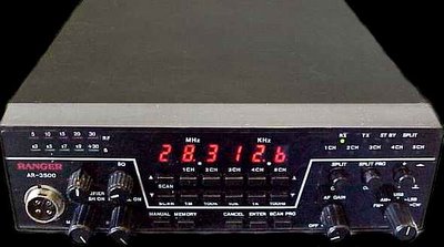

Well, I've always been partial to the 2510 over the 2600. If you do end up selling it, you can always look around for a Ranger AR3500. A simple mod makes it cover quite a spread (24.85-30mHz). Plus you get 30w AM, 120w SSB and 150w CW. With some modding and peaking, you can achieve 100w AM! Modulation is hot on this rig! They typically sell for the same price as most 2510s do. The Ranger is everything a 2510 is and more.

i llike that radio.
i llike that radio. thier the best ssb design imho
imho this radio is as close to a hf set like icom ,ect without
actually getting one.local here hadf one sounded great
good clean audio,just like a expensive hf set
