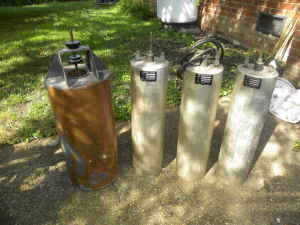

Copper and Aluminum Ham Radio Bandpass Cylinders ????
They appear to be duplexers. Typically used on repeaters so the same antenna can be used on two frequencies at the same time, receiving and transmitting at the same time.
- 'Doc
they are tunable bandpass cavity filters for repeaters or wherever two radios are located in close proximity to each other physically and frequency wise.
