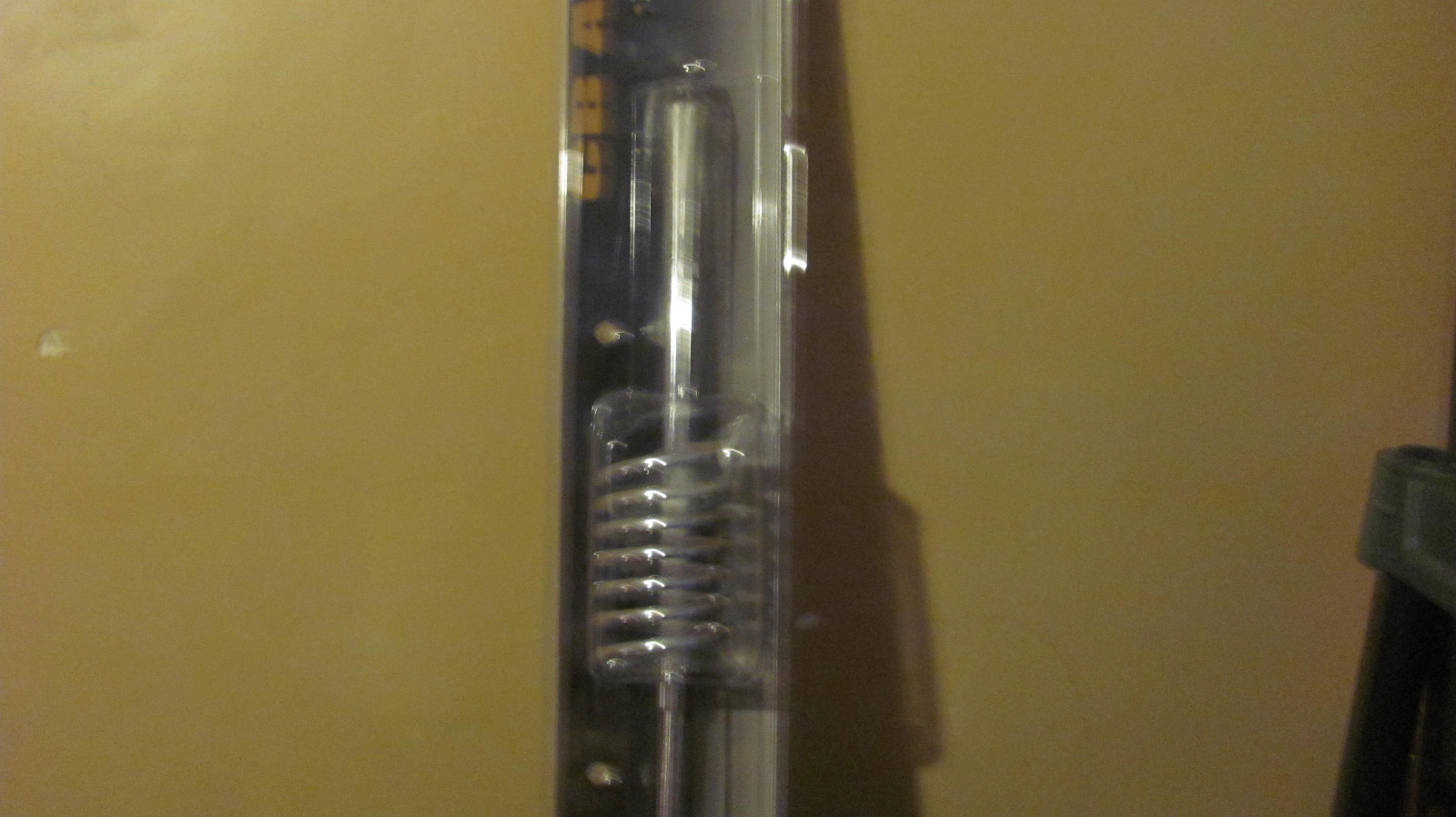

Hello everyone, I was asked what would be a better antenna compared to the Diesel 4000 Watt antenna purchased off ebay for cheap. (Like This One)
I don't know if the "Diesel Antenna" comes with coax/mounting hardware or just the main antenna "rod w/ coil".
But I had a chance to look at a diesel "4000 watt" mobile antenna w/ "the big coil" and I think the coax he had hooked up looked too thin and economical (cheap) to handle even a 2000 watts FM ( or 2 K.W. Dead Key) signal, but the antenna looked like it could?
What do you think, are these Diesel antenna too good to be true, and would a 108 in. whip out perform this
"big coil"?

Thanks y'all I appreciate it, I figure a longer vertical element and less to go wrong makes the whip a clear winner if height issues are no concern!
.... The BC has low loss from its coil and a 102 doesn't have that loss problem....
Exactly correct, The input impedance of any short antenna will exhibit capacitive reactance (-j).
In order to cancel out this negative reactance, a loading coil with equal, but opposite reactance (+j) is used.
The shorter the antenna (in terms of wavelength), the larger the coil's reactance must be, along with a corresponding increase in coil losses.
That being said,......... that chrome finish sure is shiney

Thanks, Yes that's what I figured would happen.. The "real deal" vertical whip would outperform the coil design on the Diesel, thank you for articulating so well.
