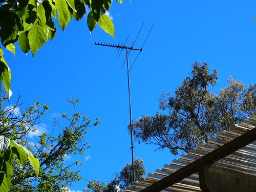

Hi everyone. I recently purchased a RCI 2970N2 with the view of utilising the CB band until i complete my local exams so I can later utilise 10 metres etc on this particular radio.
For simplicity and aesthetics (so to speak) I'm looking at using a dipole. The best spot I can think of is directly on the roof top as we are on a 2 story property on a high point. My question is as follows. I have metal roof. Our TV antenna is on a pole so as to get the best signal.
1: Will the metal roof cause interference on SWR or other issues such as conducting?
2: Would setting the dipole below the TV antenna or within the vicinity of it cause RFI. Any suggestions / help or a brand or equipment to set it right first time would be appreciated.
Thanks.

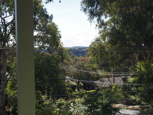

Hard to tell by the pic, but if any of those trees are yours, that's where I'd hang it. Keep it as far away from the TV antenna and the metal roof as you can, as you will probably get a reaction from both.
For simplicity and aesthetics (so to speak) I'm looking at using a dipole. The best spot I can think of is directly on the roof top as we are on a 2 story property on a high point. My question is as follows. I have metal roof. Our TV antenna is on a pole so as to get the best signal. That's probably the WORST place for the dipole.
1: Will the metal roof cause interference on SWR or other issues such as conducting? Yes, without a doubt.
2: Would setting the dipole below the TV antenna or within the vicinity of it cause RFI. Any suggestions / help or a brand or equipment to set it right first time would be appreciated. Your TV is designed to be a receiver of RF signals. In theory, 10M signals are far enough from over-the-air TV signals in frequency that they won't cause interference...UNLESS they are very much stronger than the signals you want to receive.

See comments in red.
Anything around an antenna will affect it a little bit. How much it's affected depends on a lot of things, most of which can be compensated for. I would suggest keeping an antenna as far away from stuff as possible, but, if you can't then do what you can and then 'work around it', sort of. It doesn't have to be 'perfect' to do well enough. That interfering or 'affecting' works in both direction, you may get into that TV antenna. Won't really know until you try it.

many thanks guys. yes the trees are mine. ill use that as a reference point and go high from there.
