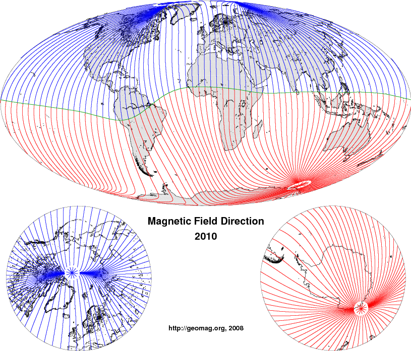

I could be totally wrong here, but I believe it has to do with FAI. From the middle of the continent to either coast is about 1200 miles, so IMO, F-layer is ruled out unless the MUF is very high. I believe what we have is E-layer during enhanced solar activity with fairly occasional field aligned irregularity enhancement in the afternoon. From here in northern MN, most of the skip I hear is Texas through Florida, and that path happens to be parallel to the geomagnetic field lines - a prerequisite for FAI enhancement (although the signal often takes a path off to the side before bouncing back).

I could be totally wrong here, but I believe it has to do with FAI. From the middle of the continent to either coast is about 1200 miles, so IMO, F-layer is ruled out unless the MUF is very high. I believe what we have is E-layer during enhanced solar activity with fairly occasional field aligned irregularity enhancement in the afternoon. From here in northern MN, most of the skip I hear is Texas through Florida, and that path happens to be parallel to the geomagnetic field lines - a prerequisite for FAI enhancement (although the signal often takes a path off to the side before bouncing back).View attachment 59430
as far as who has better chances with europe vs the pacific, i understand how that works. its the whole E coast band is open, W coast dead air. I think brandon may have nailed it here with this presentation. I may have been to quick to dismiss any E layer influence, as E layer propagation is usually short lived and sporadic, not all day into the early evening hours on one whole half of the continent.
