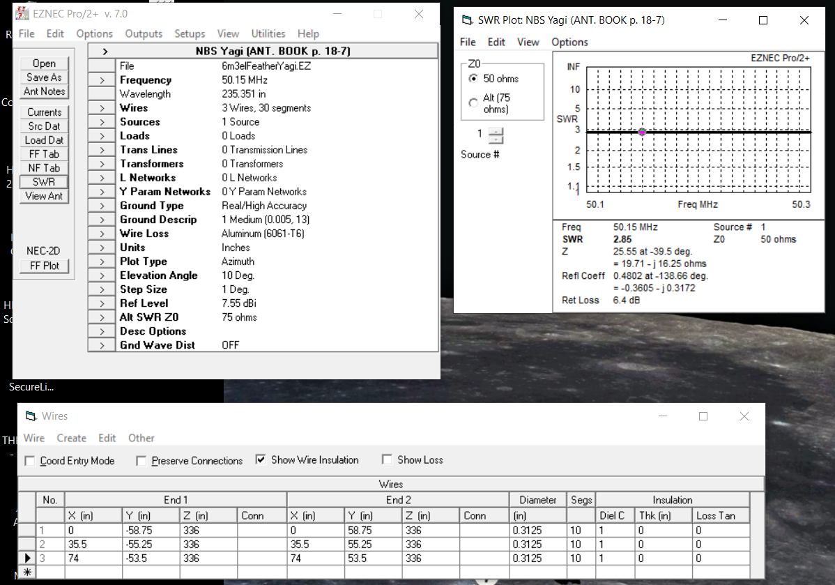

Modeling a 3 element Yagi and having trouble adding a Hairpin matching inductor to the Driven Element feedpoint. Any help much appreciated.
This is the Featherweight and I know the dimensions of the Hairpin. My issue is adding it to the model. Still learning EZNEC.
