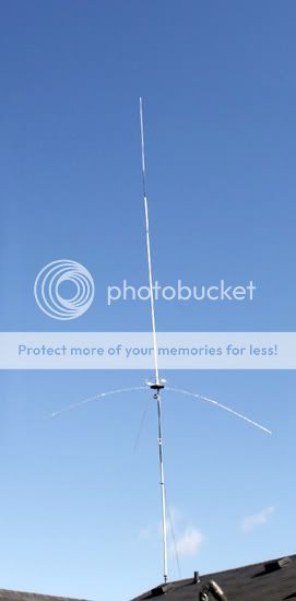

a full wavelength is gonna have a very high TOA because the vertical is too long . it should be a simple matter to shorten it to 22 1/2 to 23 ft though . how long are the ground plane elements ?
if it's 9 ft it's a 1/4 wave ground plane . they definitely work and some sometimes they're the best antenna for a particular location .
or were you saying just the ground elements are 9 ft ? i had better performance with full 9 ft ground elements than i did with more shorter ones so im a fanboy of them
can you measure the vertical ? it doesn't look 4 times longer than the ground elements in the pic to me , looks to be a 5/8 or .64 ..... nice looking antenna to . the wolf .64 uses a gamma and its a 5/8 also , albeit , it uses two separate loops along the vertical and a top hat . should do pretty well for ya (y)
can you post any close pics of it to show how its constructed . some folks here like to homebrew and theres no shame in borrowing anothers construction ideas (y)(y)(y)
can you post any close pics of it to show how its constructed . some folks here like to homebrew and theres no shame in borrowing anothers construction ideas (y)(y):thumbup:

A gamma match is used to -raise- the feed point impedance -TO- 50 ohms. A direct feed of your antenna would mean feeding a less than 50 ohm input with a 50 ohm feed line, not so good.
- 'Doc
(It can't be a full wave length antenna, it's a 5/8 wave (or /64 if you like). A full wave antenna that's end fed will have an input impedance of something between 1000 and 2000 ohms and that gamma match wouldn't even touch that.)
