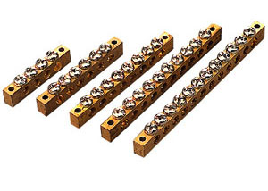

I do. All my equipment is grounded. Run all your ground wires to a ground bus, then one large gauge cable to your ground rod.
Bus bar
Bus bar
