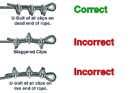

sorry I wasn't clear in describing what I meant but I got the information I'm looking for from Caption Kilowatt. I'm going to use the cable saddle clamps. Thanks everyone for the information.
Just remember to NEVER saddle a dead horse. ;) That's the easy way to remember which way the clamps are supposed to be installed. :) The U-bolt goes around the dead non- load bearing end and the saddle goes around the live load bearing end.
