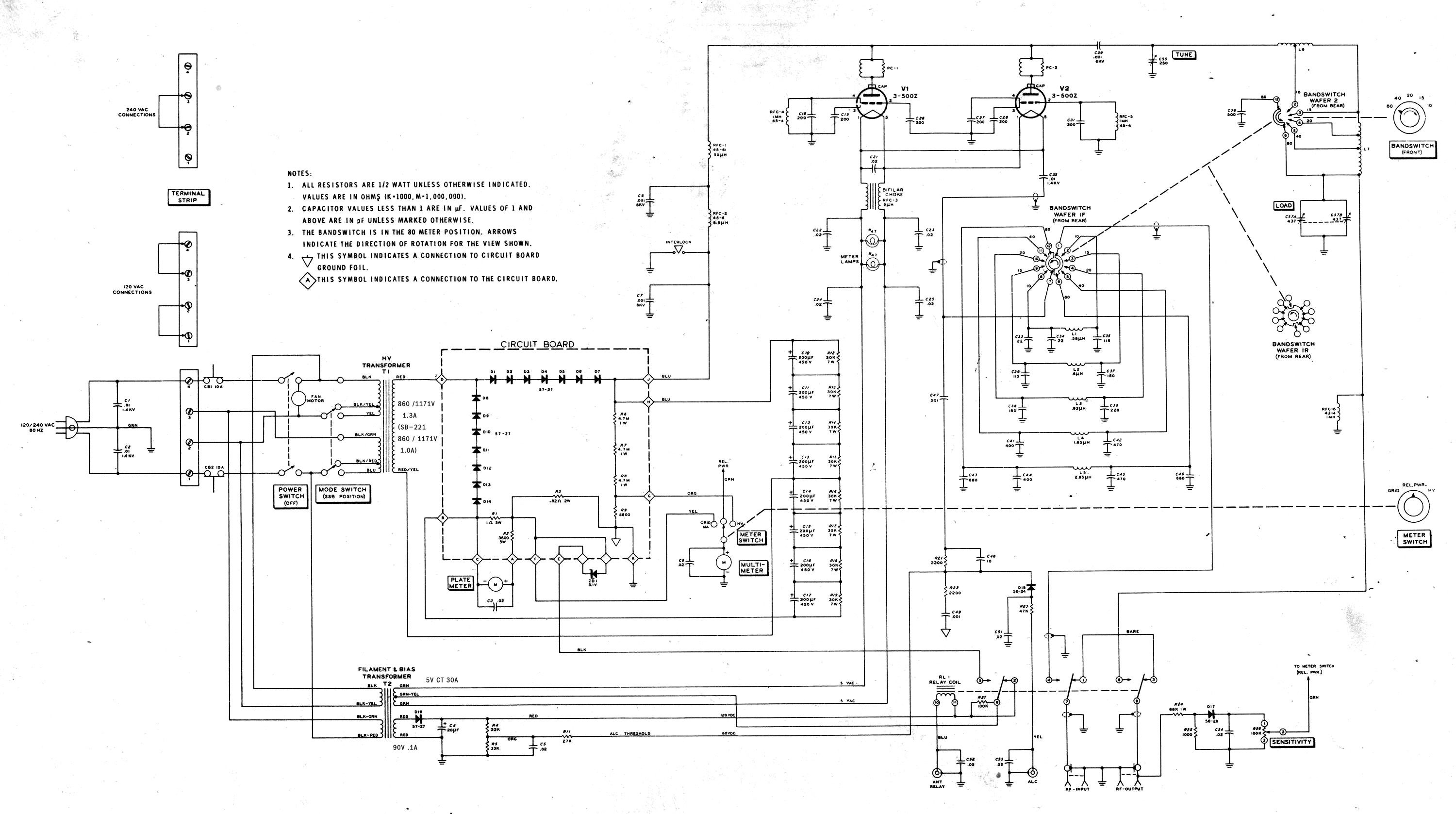

Does anyone have a legible copy of this? I know it's at CBT but it's terrible, you can't make out jack on that thing. The other models, the schematics are perfect but the 220... they've skipped it or something.

This is the best one I have, better than CBT

Thank you very much, that is better.

Well, I don’t have one. I was thinking of buying one and then I thought, why not just build one? And this probably where the comments try to talk me out of it, which might be a good idea.
I’m either gonna buy one or I’m gonna build one, so either way I need a good schematic and Doc posted a pretty nice one. Thanks again, Doc.
