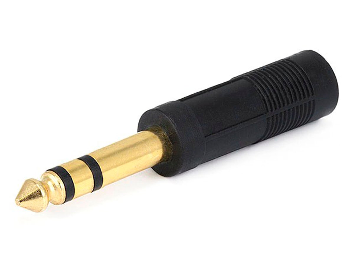

Sounds like the wrong adapter. My first SW radio was a DX-160 and I used regular 1/4 inch stereo headphones with a stereo to mono adapter and it worked great in BOTH earpieces. I just looked at the schematic to confirm that the headphone jack is indeed a regular 1/4 inch mono jack. A simple 1/4 inch mono to stereo adapter will work. You need the male end that plugs into the radio to have only two contacts commonly called a tip-sleeve connector while the female end needs to have three commonly called stereo or tip-ring-sleeve.
It needs to look like this:
NOT like this.
Thank you friend , that picture you sent what the adapter should look like sure helped. The 2 they sent where the wrong ones but with the picture you sent I found the right one and now all works well. Thanks again for your help. Al.
