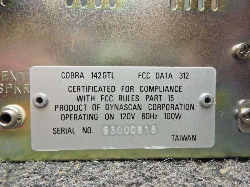

First place to look is the serial-number plate.
![wofkLs.jpg](/proxy.php?image=https%3A%2F%2Fimagizer.imageshack.com%2Fimg922%2F8269%2FwofkLs.jpg&hash=752f8577f2fef4e431a05226cc642e3d)
The first digit of the serial number is the last digit of the year. First made in 1979, IIRC. The "6" first digit in this one should indicate 1986.

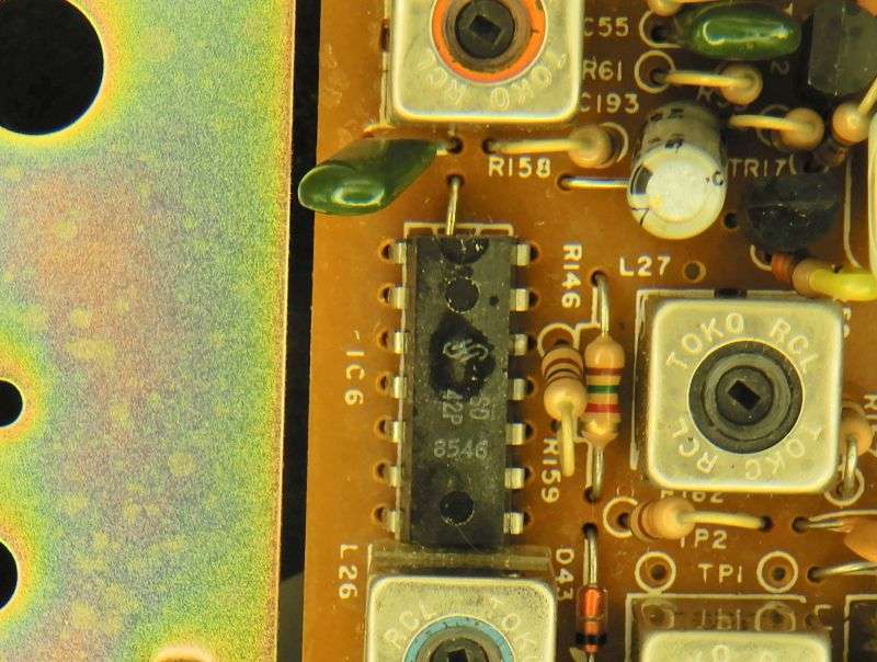

The Siemens S042P transmitter-mixer chip will also usually have an open date code.
![APdwQ5.jpg](/proxy.php?image=https%3A%2F%2Fimagizer.imageshack.com%2Fimg924%2F9540%2FAPdwQ5.jpg&hash=3895810bf873c007cd435fad7fe69d96)
This one says the 46th week of 1985. Quite believable for a 1986 radio.
