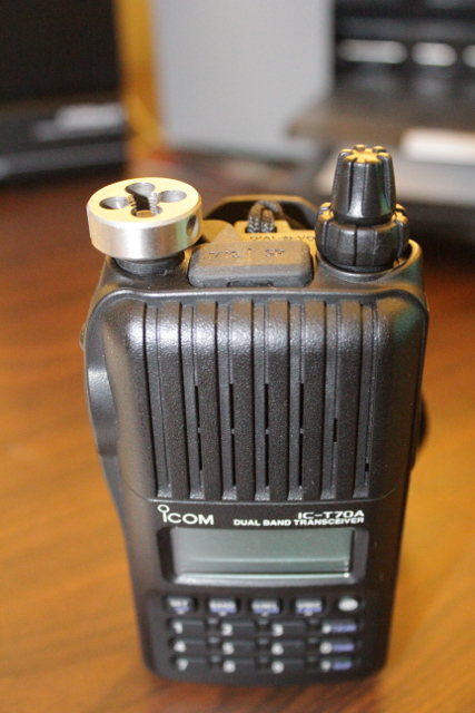

Now, just put a little cutting fluid around the outside of the sma connector and carefully thread the die onto the connector. The die only works in one direction, with the printed side face down toward the radio:
Carefully work the die back and forth until you have it threaded properly, then screw it down all the way onto the SMA connector. You should be able to do it by hand without the use of a die wrench. Screw it all the way down, then back it out and then screw it down again. Take the die off, wipe all of the cutting fluid and metal shavings off, then do it again to make sure it turns smoothly.
