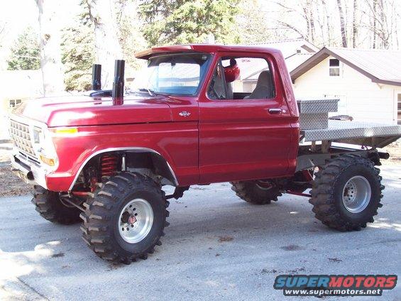

I have given up my search for the elusive 27" shaft P10K and have grown tired of my current pictured system. Not to pit one against the other but, Will a 102 whip mounted on the right rear box support structure, Half way up on the inside of the box allow the same performance I am seeing with my current abortion?

If you mount it on the right rear, it will slightly alter the pattern to the left front because the biggest part of the metal pulls the pattern off a bit.
I ran one this way for years and it worked fine.
All i did is take a heavy duty mirror mount, remove the clamp plate, drilled through the 4 holes into the support for the stake holes and used some beefy sheet metal screws to mount it.

I think you would have as close to the same performance, or maybe better than now. I would mount that whip as close to the top of the box as possible, but it shouldn't make a huge difference either way. As far as skewing the radiation pattern, you'll never know it, it doesn't make it very directional at all (moving it to one side or the other).

I REALLY like the ford in the back ground. I have a 78 that I re did with a deck on the back and a plow. 351m, auto 4wd with 33 12.50 tires. I love it.
My father tweaked the bumper a bit but she is a working truck, not a showpiece.

why not just get a tram tri pad and stick that antenna on the roof were it will
perform its best?could also puck mount it on roof.id install it differently.

But they have them for sale:( sorry, that's where I buy all my predator stuff and I have the 27'' mounted to the far right rear of my 70cst which is a tad directional but it's not too bad.
