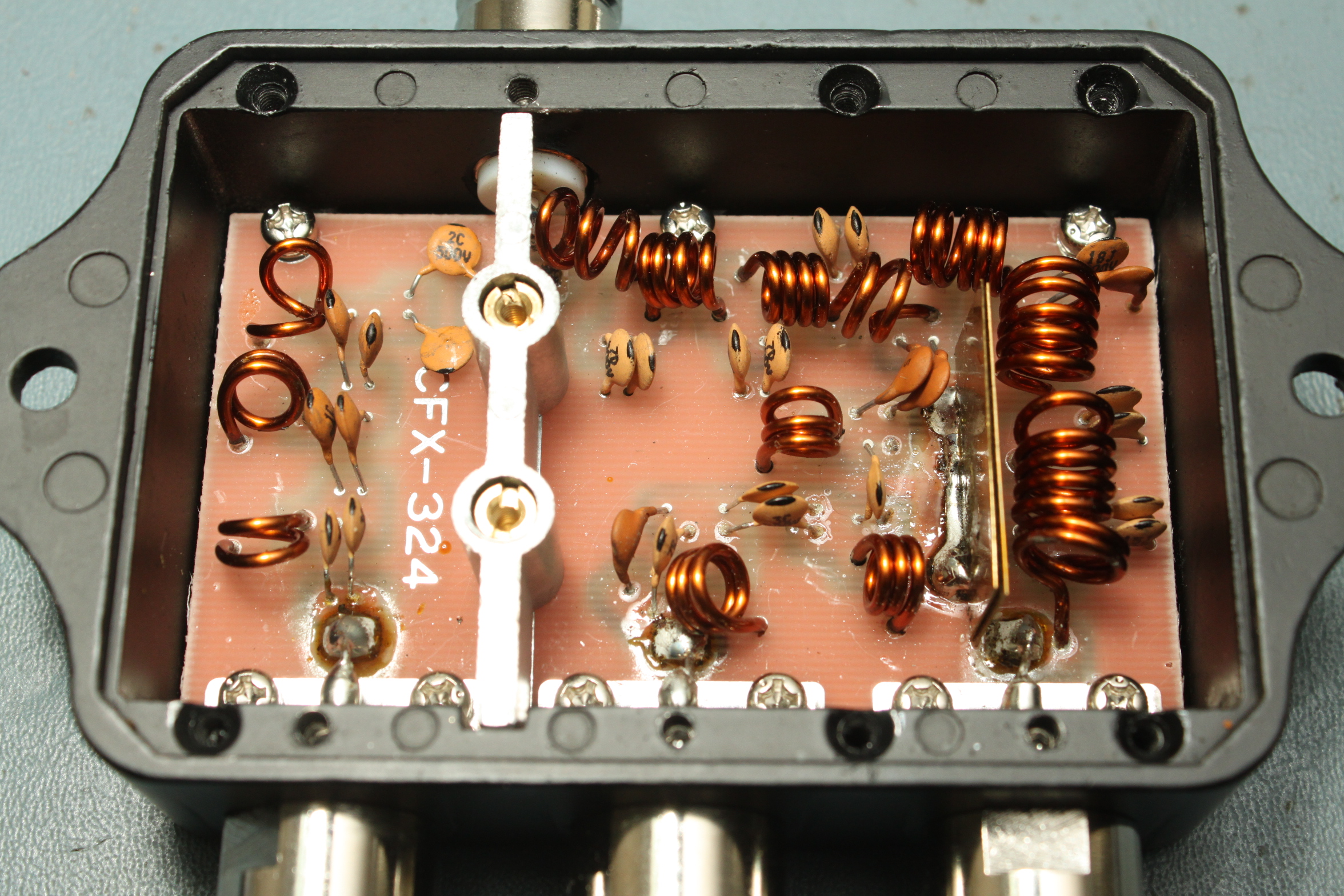

Inside a Comet HF-144/220/440 Triplexer

I picked up a Comet CFX-324B Triplexer today and thought that there might be some interest of what these things look like inside. The ports on this triplexer are for 1.3-150Mhz, 200-320Mhz, and 390-500Mhz with more than 40dB of isolation between them. Power is rated at 600 watts PEP.
I also decided to do a simple attenuation test on 2 meters to show how quickly past 150Mhz the power output cuts off. I hooked up my HT with a fully charged battery to a meter and dummy load and ran some output tests. I've indicated the frequencies where I see the most dramatic change in attenuation:

In case you're wondering what I'm using the triplexer for, it's going with my FTM-350. I have a 220Mhz 20 watt amp inline with a 220 J-Pole, so now I can crossband repeat on 2m, 440, and 220 Mhz. :tt2:
