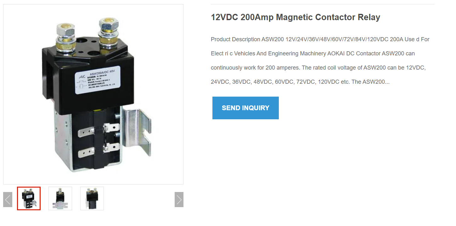

A battery isolator, as mentioned, is the correct way to do it. You can also use a a 12VDC contactor wired NO and wired to your vehicles ACC. This way when your ignition is on, you will be charging/using both batteries, when the ignition is off you will only be using the secondary battery leaving the primary unused. Something like this.....
