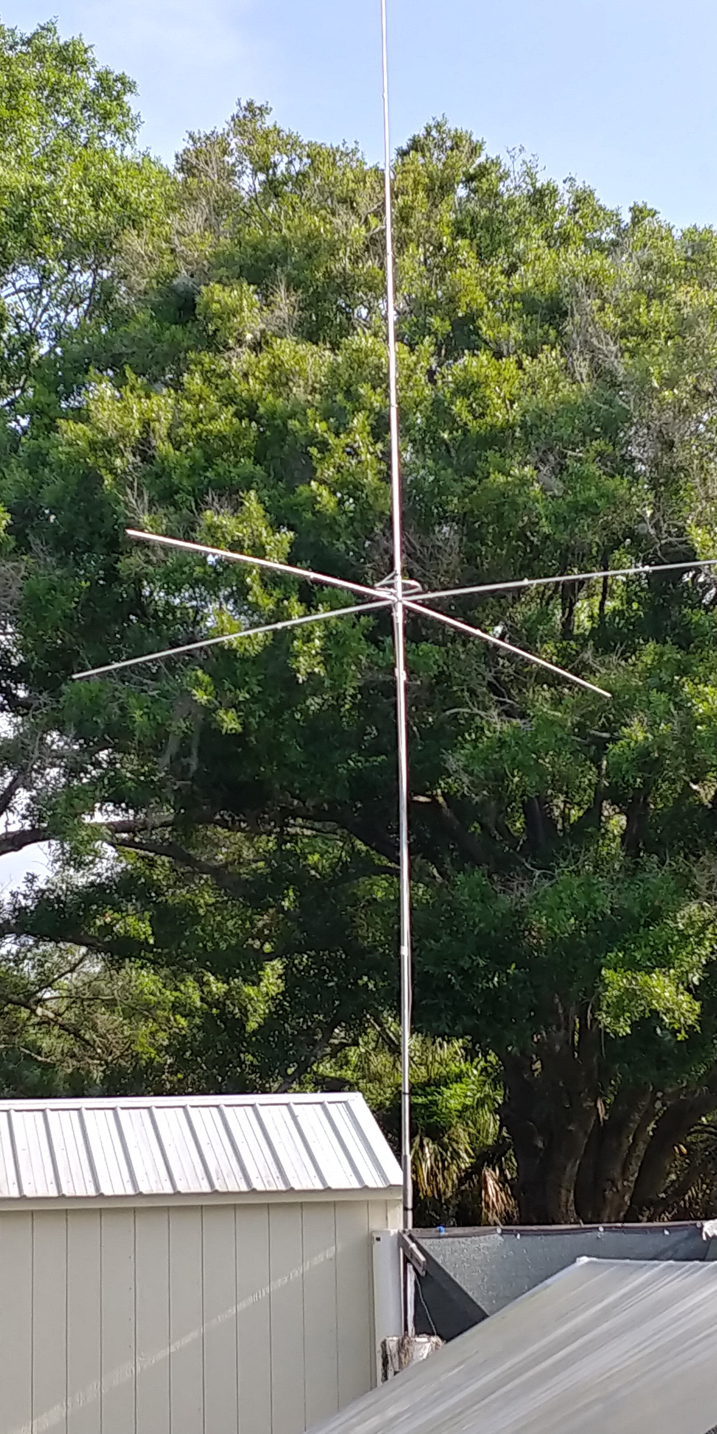

Yes we are in a sub-division. Antenna will be mounted approximately 6-8' above the high roof line, 2-story home. Looking for vertical antenna, any recommendations?

Sirio Tornado
has my interest at present though I’m not a homeowner.
The Sirio Gainmaster or 827 or 2016 (yet more models) will take you through a fair range of opinion when researched. Start point if you want.
The
Hy-Gain SPT 500
is a re-issued classic, also to my interest.
