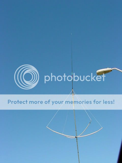

BammBamm,
Given the situation as you described it, What I'd do in his place is a 1/4 wave ground plane like this one except the four GP wires would be drooping over two sides o the roof ridge line made of near invisible wire. All that would stick up would be a whip.
