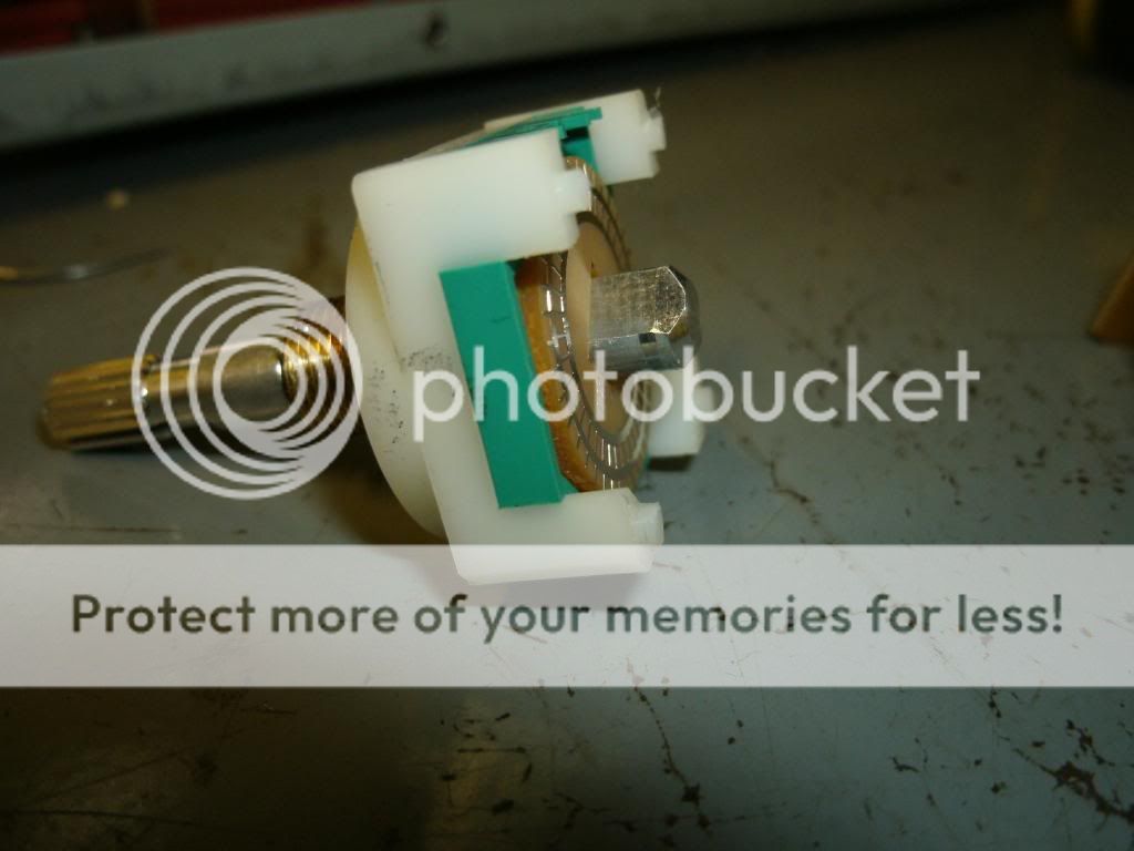

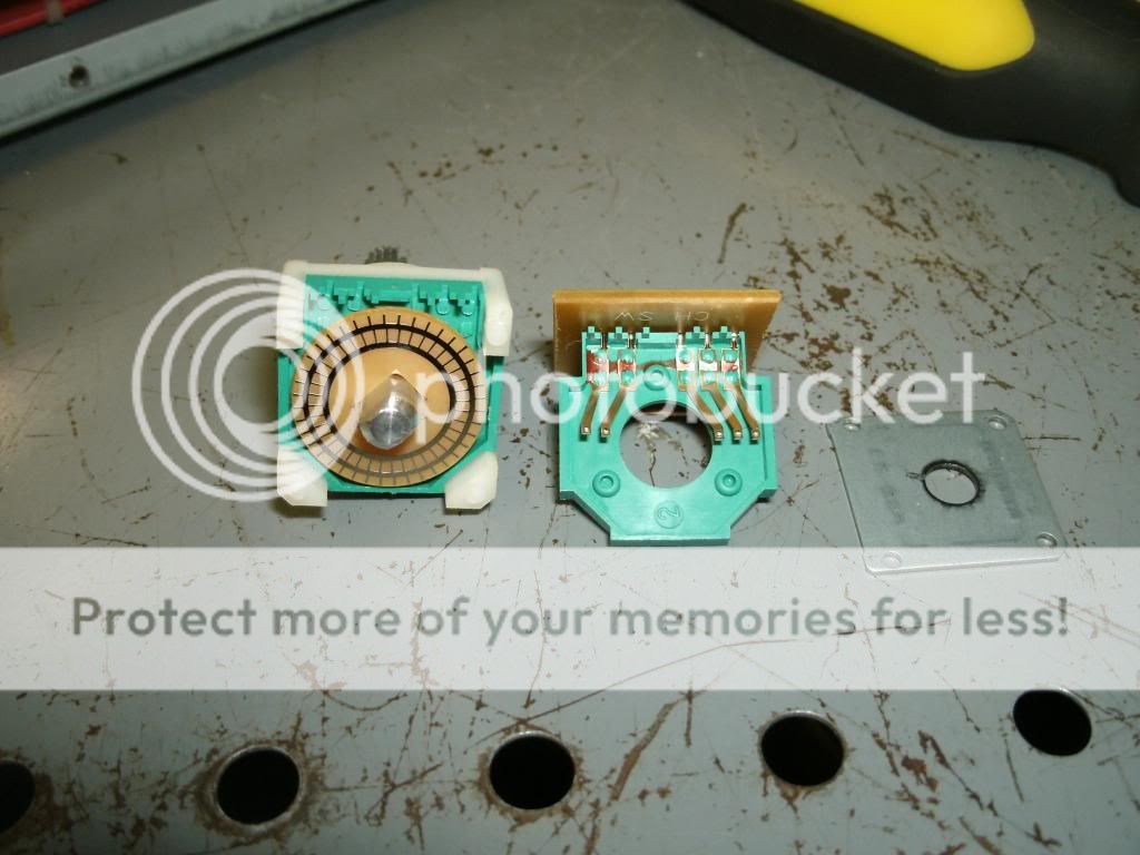

ok working on my Rotary Channel Selector RCI-2990 and I was told before it cant be fixed... so being the Pollock I am f what people say!!! ^^ ab v c^^
I used a super fine polish on the copper and the contacts with a Q-tip gave them a little "bend in"
so I have some radio shack Cleaner / Lubricant would it be a good Ida to spray that in before I put I slap this thing together or just leave it dry?
this is what I found inside so simple :thumbup1:I have tinney eyeglass screws to hold the back on
Never leave a switch dry. It will wear out in no time. Spray it with the cleaner/lube you have. It's about as good as any since you have already cleaned the switch.
Thanks for getting back to me I was thinking the lube would be good to keep the copper from oxidizing and stop the contacts from cutting in to the copper but at he same time I don't want it to some how gunk up in there..
I got it back together with 4 eyeglass screws and it is working like a dream!
