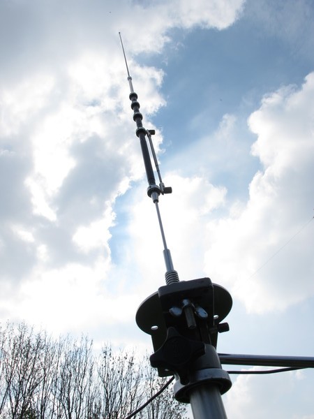

Also took delivery of an ICOM AH-703 portable multi-band antenna, covering 7, 14, 21, 28 and 50 MHz with a 1/4 wave design. Power capacity is up to 20 watts. It's assembled length is 4.6 feet (1.4m) high and weighs a mere 12 ounces.

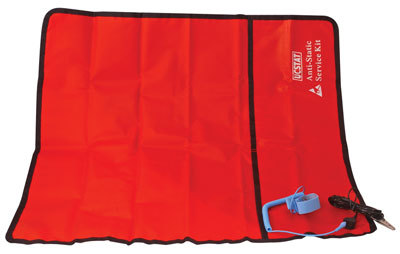

Ordered this on ebay from Jameco:
FIELD SERVICE KIT CONDUCTIVE PVC W 6' WRIST STRAP 10' GROUND PVC MAT 2' X 3' ESD ($23. with CA tax & shipping)
It should be here by 8/1, then I can start handling the circuit boards and finish this kit up.

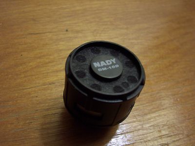

While on still ebay, ordered a 600 ohm element to replace a broken one in a Kenwood MC-43 hand mic.
Dimensions are 1" x 1" ... so it should fit. ($10. free shipping) :wink:

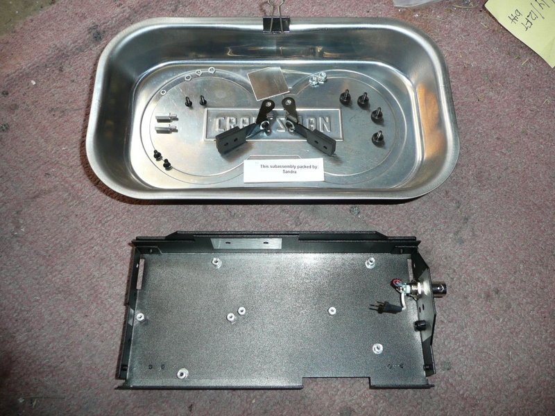

... then prepped the covers (removed the protective grounding point tape), installed the standoffs, heat sink, rubber feet and the BNC connector in the bottom cover. The hardware is 4-40 and 2-56 ... pretty small stuff for old eyes and hands :laugh:

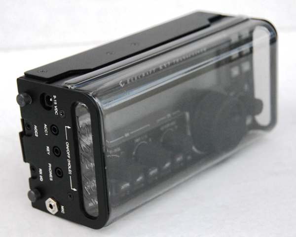

The GEMS PRODUCTS side plates and face cover arrived yesterday ... a lot quicker that expected. These things are a really nice option (this is what they look like):
Their web site doesn't indicate where they are located, but the mailing label says Fullerton, CA (about 30 miles away).
Still waiting for the ESD mat to show up ... then it should only take a short time to complete the kit :fingers crossed:
Our postman delivered the static mat yesterday (a day early), so I finished building the kit late last night (and on into early this morning).

Made up a counterpoise wire approx 20' long and attached the AH-703 antenna to the connector with a BNC-SO239 90 degree adapter (sitting on my desk inside the house).
A quick push on the ATU button:
20M SWR = 1.8:1 ... readjusted the shorting bar and on 40M, SWR = 1.0:1 :thumbup:

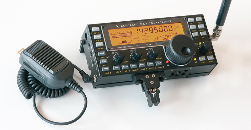

The paddles are an option. KXPD3 Precision Iambic Keyer Paddle, $130. :eek:
I pretty much suck at CW so I didn't order it. I understand that you can use any type of key you want though.
I haven't tried this feature yet, but it supposedly decodes CW to text on the display screen :thumbup:
