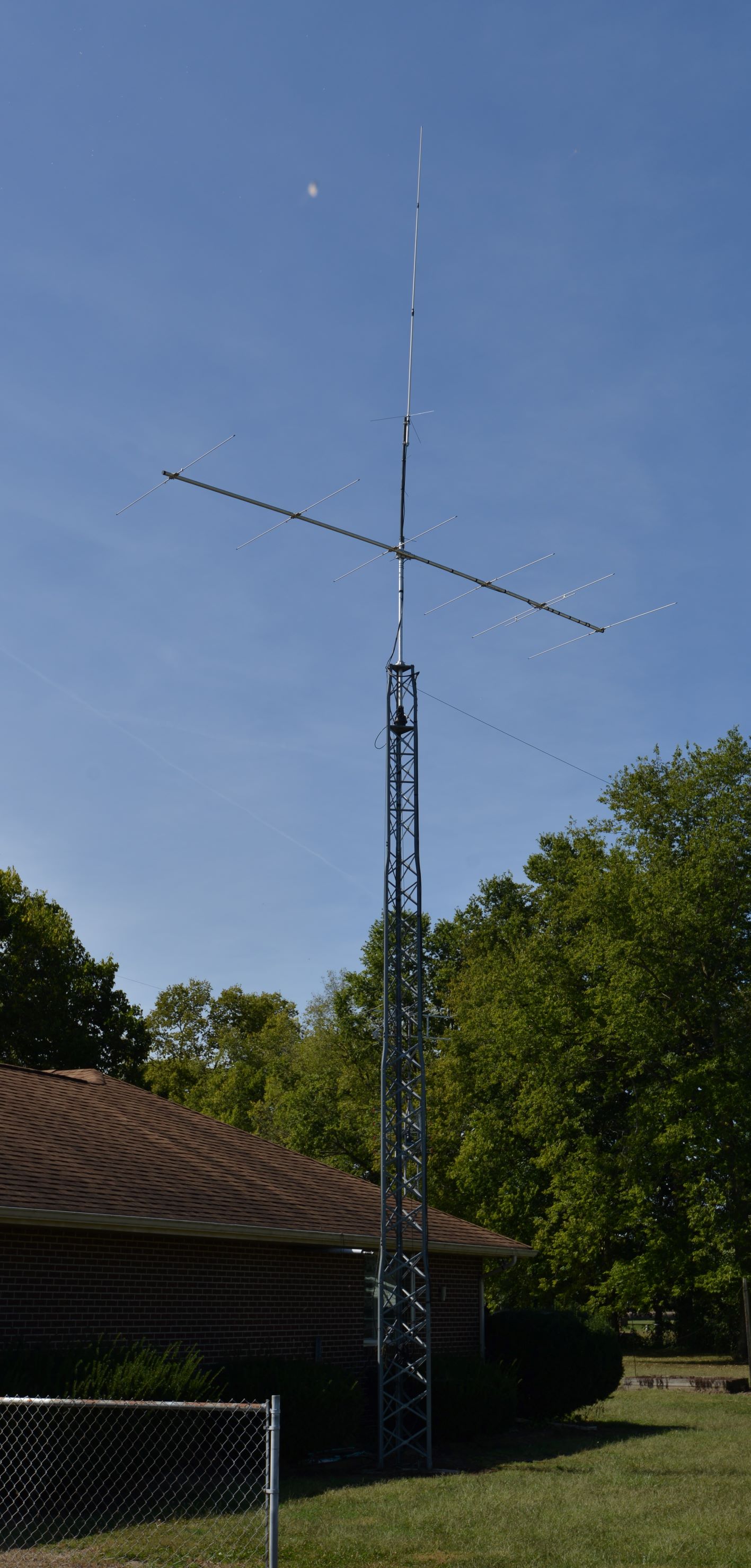

That's a Yaesu G-800DXA rotor on that antenna (6 elements on 25 ft boom for 6m) plus the 2m GP (16ft tall) @ 40-45ft to boom height.
GS-050 YAESU GS050 50mm THRUST BEARING (MAST DIAMETER 1-1/4" - 2") (rlham.com)
at the top of tower.
Gary
