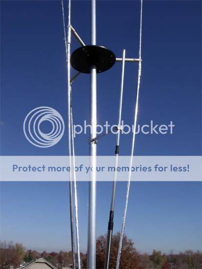

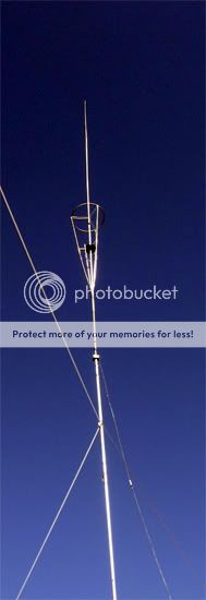

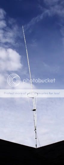

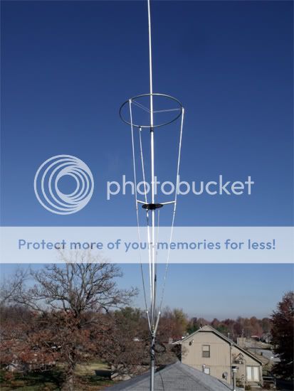

I decided to use the materials I had at hand to make another antenna to replace the Qv4k I had traded away for a radio I wanted. I knew I could always make another antenna, and lacked the skills to build a radio.
So I did. Here is the Made in the USA SigmaIV ;)
This antenna is built virtually identically to the SigmaIV discussed in at least two prominent threads on this forum.
The only significant difference is the ring is slightly smaller in diameter because it is preformed and served to get the project kicked off.
It's very windy today!
More later. Time to go to the Home Depot and earn a living.
More adjusting to do later, But here is SWR bandwidth with MFJ-209 at the shack end of the coax.
2.1:1 ---------------------- 28.155
1.5:1 ---------------------- 27.840
1.0:1 ---------------------- 27.565
1.0:1 ---------------------- 27.555
1.0:1 ---------------------- 27.445
1.5:1 ---------------------- 27.085
2.1:1 ---------------------- 26.600
Initially, it appears to be less widebanded than the Qv4k, but I will have to look that up and do some more adjusting. It is 4 feet above the roof ridge for now - 23' from the ground.

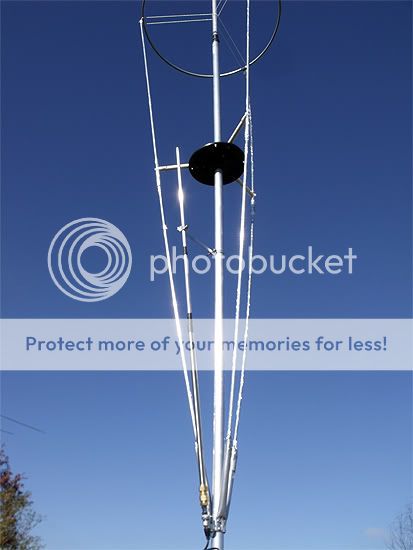

i see you went with three basket elements this time . was there a reason other than just trying something different than before or just using materials on hand ? i think i recall a comment somewhere about the making the ring larger than stock making the antenna more broad-banded . i,ll see if i can find it in a bit tosee if i'm wrong again ... if i'm not the smaller ring may have something to do with the smaller bandwidth you're seeing on this one . what diameter is it ? also what length did you make the basket elements and vertical ?
can we get some closer pics ?

You're correct, Booty,
I used what I had. The loop is 27.5" diameter. It has three pre-attached ears on it at exact spacing so I just put three basket radials on it.
As Bob said, it likely is more broadbanded with four, so I'll likely upgrade to four radials.
As for dimensions otherwise, look back into the "... an alternative view" thread and you find the assembly dimensions I used. They are stock SigmaIV.
