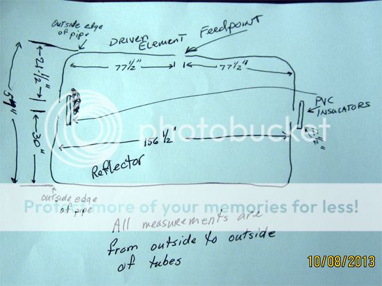

Dimensions:
No, I didn't put the analyzer on it and fine tune the dimensions, so the exact point of resonance is unknown to me.
I did, however, point it directly at Scotland and the exact point of contact was right there. ;)
Reactions: 1 person
Dimensions:
Homer, here is my model of your older Moxon from a while back that was tuned to resonance. I modified it to your newer dimensions with another model to see how they compare.
This might give you a clue where your new model might be in resonance...since you didn't check it with your 259b. If you do check it with your 259B later, please let me know how close the new model is in frequency to your real world results. I fixed both models to .625" in diameter.
I posted a recap at the bottom of my notes, for both models over Real Earth, and in Free Space.
I added my Exnec dimensions to both models for your information.
It looks like the new model is a bit lower in frequency, and I did not try and retune it.

Thnx, Marconi. I'll try to get that done. I had only a small window of time to get it together and up in the air. I'll double check all dimensions for any errors and test it with the 259b.

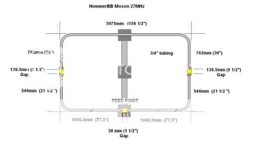

here is the same diagram cleaned up, but made for me by a friend:
Reactions: 1 person
That looks good Homer.
You may see a little difference in resonance since I used .625" elements, and I think you used .75"> inch. I also didn't account for your dimensions being to the outside of the tubing all around. You will probably see some difference also due to using a feed line, the bandwidth should show to be much better.
