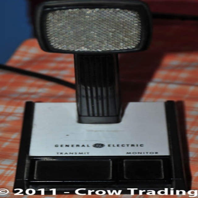

shure mic or ge 19b209694p1?
hi all i have what seems to be a shure non amplified desk mic..controlled magnetic 19b209694p1 is on a sticker on the bottom plate...trying to find out if indeed this is a shure manufactured mic.. if so whats the true model number ? if not, whats the ge model number.... and where to find wiring diagrams and other data on the mic.?
john,kb9ikh
GM: Looks like a Shure 444M(D)....Shure private labeled a bunch of variations of that mic....
Drake/Swan/Dukane....etc...
There were a few differences in the elements...but have not heard one that sounds bad or really ugly unless you hook them to a "Clip joint" radio....
I have run one on my Kenwood TS130 or TS450 for years....
