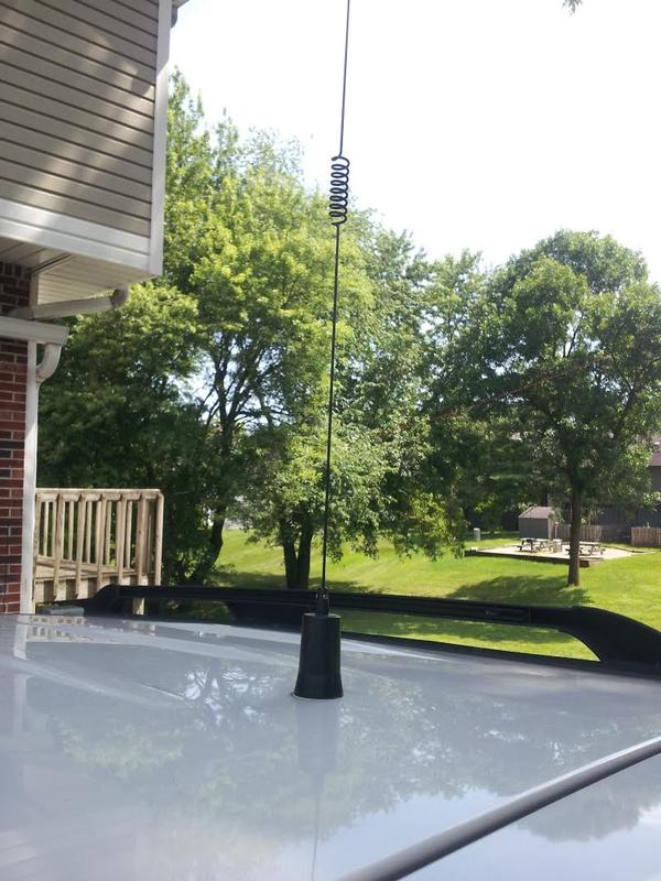

Whats going on guys.. Wondering if anyone could recommend a good mount for my sirio turbo 5000 pl antenna on my Acura suv? I purchased the magnet mount for the sirio but not sure that is going to be the best way to go.. I do not want to drill any holes into my suv, I keep my vehicles in pristine condition.. So besides the magnet mount , what kind of mount can I use for my suv, and where should I mount the antenna.. I was looking at the diamond k400 and it says trunk or hatch mount.. Not sure where I would put that, maybe on the side of the hatch door?? I also need a mount that is going to handle some power, maybe 1000 watts on the high side, not sure what I am going to run yet, but I need it to at least handle that kind of power.. I want a good mount so I do not mind spending the money on one.. I also do not have to go with the sirio antenna either, if you guys have a better antenna to use, then I will buy another antenna if I have to.. I figured though the sirio turbo 5000 would not be an eye sore on my vehicle, over say a predator 10k.. Any help and or recommendations would be greatly appreciated on the best setup... Thanks guys...

Mag mounts
There are many reasons to permanently install any mobile antenna. Aside from maximizing performance by minimizing ground and shunt capacitance losses, there is the safety issue should the antenna come unstuck. Further, some insurance companies will not cover antennas which are not permanently installed. These facts preclude the use of mag mounted antennas.
The one shown in the right photo is a typical unit. When they're demonstrated in retail outlets, they're stuck to a thick chunk of metal. Since the amount of sticking force is reliant on the thickness of the material it is stuck to, the actual force will be much less when it is sitting atop your vehicle. It doesn't make much difference how many magnets they have, or how big they are. The fact remains they will become flying missiles in the event of a crash.
There are two more problems users should be aware of. First, they collect road debris (mainly metallic brake dust) which eventually gets between the magnet and the sheet metal. Secondly, the base cover, usually a rubberized plastic, has an affinity for clear coat vehicle finishes. It is a given that the surface under the mag mount will become both scratched and/or discolored over time. In some cases, less than a week! The bottom line is, if you have to resort to a mag mount for your antenna, you haven't thought long enough about other, safer, more efficient, mounting methods.

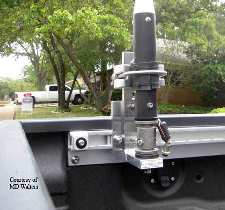

Bed, Clamp, Clip, Lip & Trunk Mounts
There are several things to keep in mind when using any non-permanent mount, no matter how it attaches. First, it is no better than the vehicle sub-structure it is clamped to. A typical example is a roof rack. Most are not DC grounded to the body of the vehicle. Even when they are they still represent a poor ground plane even at UHF.

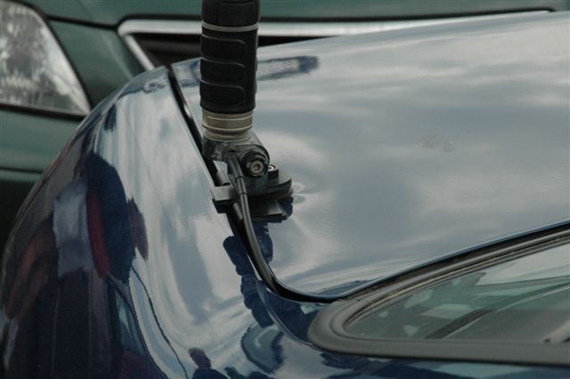

Clamp mounts like the K400 shown at right might save you from drilling a hole in sheet metal, but that doesn't mean they don't cause body damage, as the photo of the K400 above depicts. Since the return path for the coax relies on the integrity of the hinges, and the mounting set screws, it isn't an ideal situation ground loss wise. Adding insult, most clip mounts come equipped with a preinstalled RG174U coax assembly, although some use RG58A. The cable is usually 10 feet long (3 meters actually). At 30 MHz, the loss averages about .5 dB, and increase to about 1 dB at 150 MHz (≈2 meters). At 450 MHz (70 cm) the loss is almost 4 dB. Add in some ground loss, some impedance mismatch, and the total loss attributed to a clip mount can easily double the aforementioned figures. Incidentally, the motor lead choke shown is totally inadequate!
