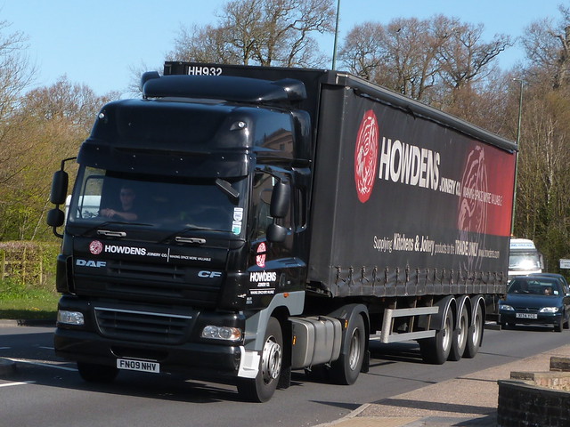

Talking of trucks, this is who I drive for and what I'm currently driving. DAF CF with 45ft semi-trailer running at 44 tonnes/97,000lb, 460HP, 12 speed automatic gearbox and we get just short of 10MPG. Just about to renew the entire fleet because at 5 years old they've got a million kilometres on. Not bad when you think we're restricted to 90hrs driving a fortnight and the speed limiters are set to 56MPH.
