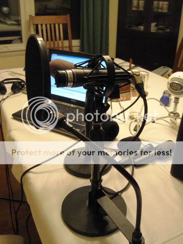

As for condensers, I have a few, and I recently recorded a podcast for a famous NY Times bestselling author who is a friend of mine (I’ll post the link if anybody’s interested, it’s not directly radio-related). I had planned to use an Oktava MK-319 for her spoken word part, but had to record her in her hotel suite when she was in town, and the huge A/C units outside were pumping out a lot of noise, even though we were on the 11th floor, too much to be able to use the large condenser. So I thought about it for a minute and grabbed an SM-58, removed the ball pop filter and placed a pop screen 4” in front of it and went with it. I still had to use noise reduction during production, but it worked really well. I recall reading a shootout online between an SM-58 and an SM-7, and the recorded results were very, very close.
Here’s that setup, but taken when I was experimenting with mics for some voice over work a bit earlier:
Believe it or not, the old SM-58 can do quite well for this kind of work, but if you’ve used one you know you can’t get right in them. The proximity effect is really noticeable on them.
