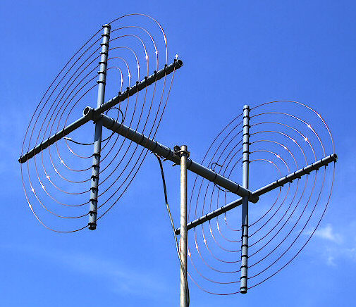

Look at this new antenna, they have a 10 meter version, I would presume with an antenna tuner, it can be used on CB, any comments?, and the price is right..
They will make a 11 meter version if orders are placed I just found this out..shipping 14 dollars

It's an end loaded 1/2 wave dipole. New form but old idea. The claims sound half way reasonable, don't know about the price though. Also don't see why it wouldn't be much cheaper to just make one your self, shouldn't be that difficult. Oh well.

with a 30 inch boom it looks only a few feet tall in the pic . im sure someone will put it on a mobile if they havnt already .

'Doc, can you describe to us what the old idea dipole you mention, looks like?
Is this one vertical or horizontal?
One picture shows a rotor. I guess this radiates like a horizontal dipole, broadside to the boom in this case, right?

What I was referring to was a 'loaded' dipole, usually having longer 'slender' loading coils instead of flat 'pancake' type coils. Most I've ever seen have been hung horizontally, but there's no reason it couldn't be hung vertically.
This thingy ought to have about the same directionality as any other (horizontal) dipole, at least, I don't see why not. And as the guy points out, like any other rotating dipole you would only have to turn it a 1/4 turn to cover all directions.
If I can remember what I did with it, I've got some #8 or #6 hard drawn wire around here, and the PVC pipe shouldn't be all that difficult to round up. Far as that goes, almost any size wire that's stiff enough to support it's self ought'a work. The alligator clips are the thingys I don't have...rats. Oh well, I'm gonna try it!

Doc, I think these are pretty neat and would be good to experiment with. This particular one is obviously a archimedean planar spiral, but it would be cool to see the effect of using a conical spiral or better yet a fermat spiral. I think I remember the direction of the winding affecting the reception of either right-handed or left-handed circular polarization. These aren't really new and you wouldn't be stealing his design. I think I ran across similar ones being used for galileo and gps antennas. Hope you get a chance to try it out and adapt it for different bands, let us know.

So what is the polarization of this thing?
Most all spiral like antennas seem to be horizontally mounted not vertically.
Also did I read that right a half-wave that does not need matching? I guess it depends on where you tap the feed lines to the spiral?
