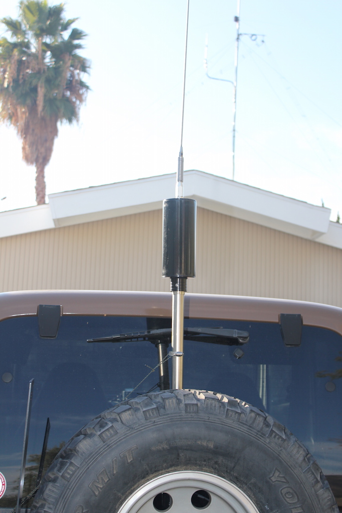

I attached my stinger with the spring base, added a hose clamp 1/2 way up the base for my guy / security line and took a couple more pics:
Here is a pic from the side showing how it is mounted on the rear tire carrier:
I already had a shunt coil, coax, & controller wires ran, so the install was pretty easy. I did a quick analyzer check and found that I could easily tune the antenna for 6-80 meters. One thing I noticed about this new antenna is that amount of adjustment needed between the 10 through 20 meter bands is significantly less, making operation much easier and quicker. Also, since the antenna is a whole foot shorter, there is a lot less leverage at the top of the heavy coil, which means it should be much more durable in the rugged Southern California deserts and mountains. All things considered, I don't think you can do much better for HF mobile communications than the Hi-Q line of antennas.
