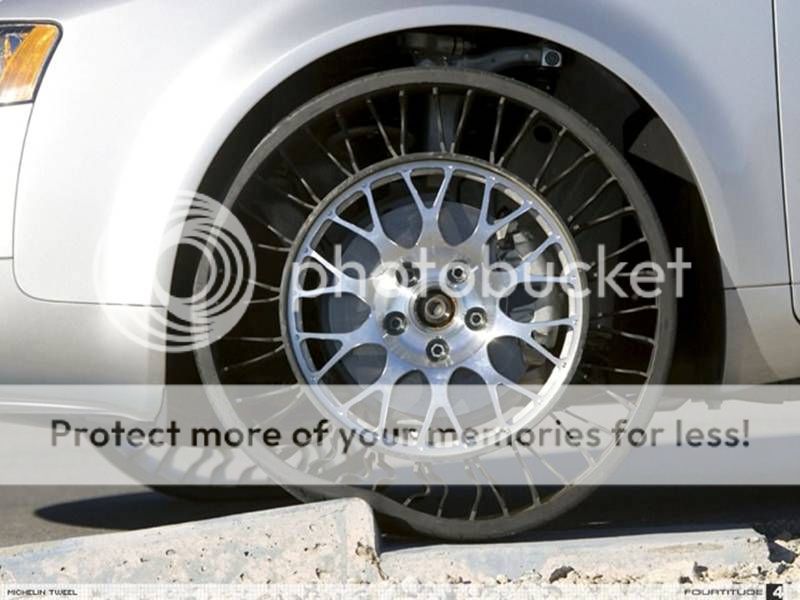

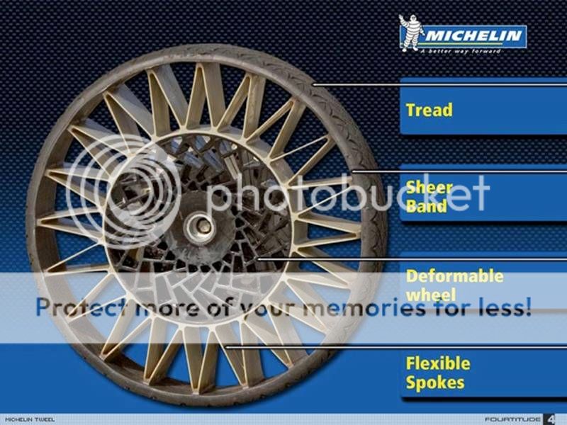

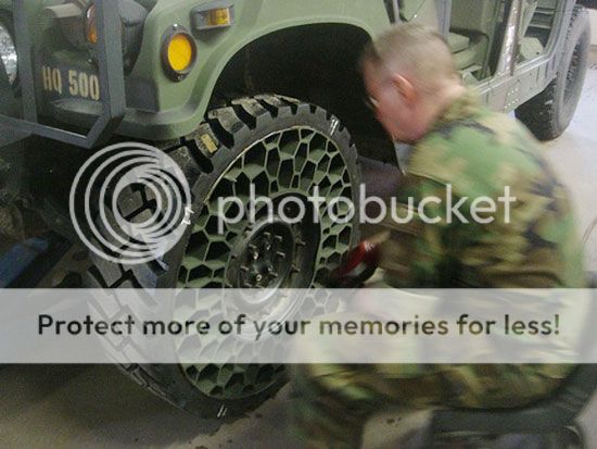

The one thing that came to mind about these tires is,
Would they get mud stuck in the openings and cause a wobble at high speeds????
i wouldn't hesitate buying these for my chevy trailblazer.
what do you think about these new tires?
Probaly no more wobble thay yer 20" gangsta rims.
I'd buy a set. No more flat tires or worrying about air pressure.
If they really want to torture test these they should put a set on my Ex's car.
The Tweel does have several flaws, however, the worst being vibration. Above 50 mph (80 km/h), the Tweel vibrates considerably, which in itself is a problem that also gives rise to undesired noise and heat. A fast-moving Tweel is unpleasantly loud[3] and produces 5 percent more friction compared to a radial tire.[2] The Tweel can also withstand a police 'stinger' spike strip, which would force law enforcement to adapt in order to stop a suspect in a vehicle equipped with Tweels.
