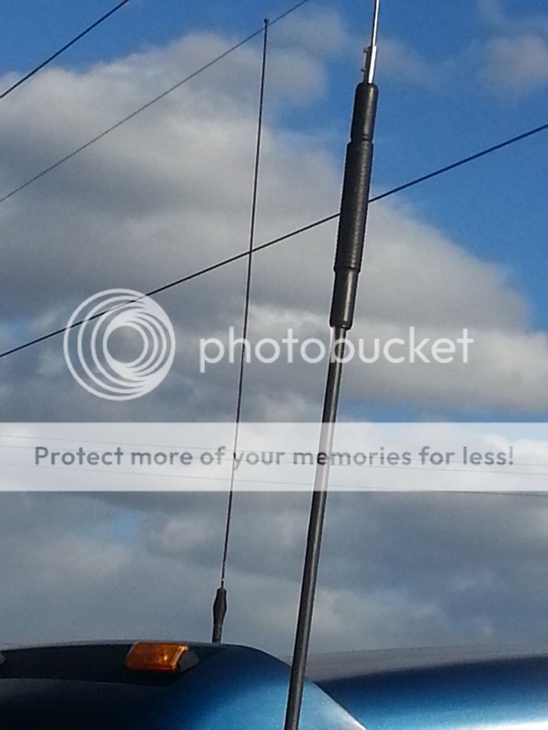

Hard to beat these stainless/copper antennas for a tractor trailer.
Just a shame that in the above two pictures they've not got a groundplane worth a damn. Quite sure it meters great but that meter is DC....
For us "Lorry" drivers and like a lot of other mobile operations too, ground planes aren't always achievable due to limited antenna mounting areas. But it doesn't mean are setups can't be more than adequate for what we are running. :cool:
Reactions: rabbiporkchop
In this pic, Is the horizontal antenna element part of a mobile dipole setup? If so it should be equal lengths to each other and the horizontal has no mast under the coil like the vertical element.
Also I'm curious to know if you ever checked the the impedance at the antenna feed point with a analyzer since you are using two 50 ohm coil matched antennas and probably using 50 ohm coax if the analyzer reading was still 50 ohms. My guess would be a 100 ohm load and a mismatched impedance with 50 ohm coax unless using a 2:1 balun.
