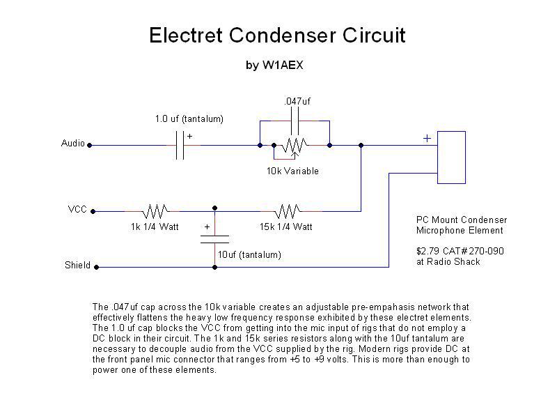

Here is a circuit I would like to try..
I just got done building a couple condensers using the phantom power directly from the mic plug on my radio, but I'd like to build a couple using that schematic..
Yes that is what I am doing too. Back in high school, I thought I was hot snot because I wired my power mics to take power from the mic pins. This way I did not need those expensive 7V Mercury cell batteries. It was a different time back then. LOL I do not mind power mic's just depends on what you are trying to do. For the most part, though they are not what most of us are after. I do still like very narrow audio bandwidth when being heard is all that matters!
