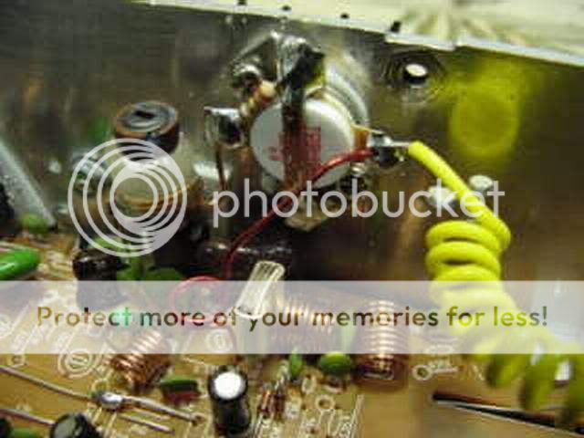

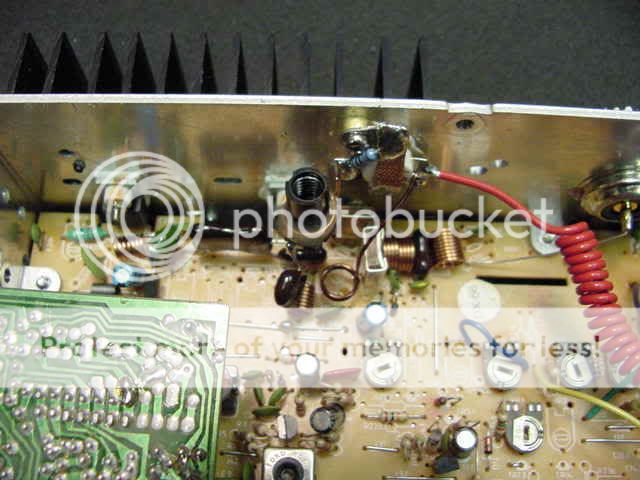

I talked to a driver today that was talking on a very loud but clear Stryker that some one had modified with a 2290 instead of the factory pill. He told me that he was seeing close to 90 watts from it. Can this be done and if so is there more to the modification that just changing pills?
I know that you can do the 1446 swap ( least i have been told you can) but i wondered if i would see any increase in power in doing so. The reason I'm thinking of trying this is so i can see more than the 45 pep watts that the radio does now.
I know i could see more if i clipped it but i don't remove the limiter in any of my radios any more because i hate the way they sound clipped!
