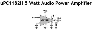

I did go over the caps and they all looked like they were correct . Failing audio chip ? interesting , this radio has the UPC 1182H ? It basically sounds like it's trying to receive when turned on (white noise) you can get above that noise with turning the volume up , it tends to knock out the snapping , crackling white noise not so bad during DX but local you can hear the noise much better when there is less noise being received . Almost sounds like bleed over scratch and there's nobody there 40 channels up or down whatever channel your on , the crackling sound seems to be off and on and some times louder at times.
Hard to find a clean datasheet for the 1182H. On the one I did find it looks like pin 1 is the input. Lift pin 1 and check if both the receive audio goes away (verifying that pin 1 IS the input) and see if the popcorn noise remains. If the noise remains the IC is probably bad.
Once in awhile this problem can happen from the DC blocking cap on the output going to the speaker getting leaky. It's the largest electrolytic connected to the output, pin 5.
