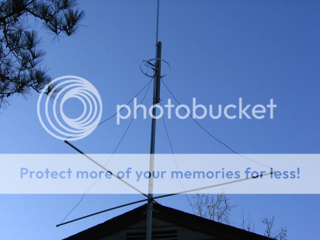

heres my homebrew version :)
only took me a few years . LOL
http://www.worldwidedx.com/home-brew-mods/38300-64-homebrew-temporally-finished-up-pics.html
