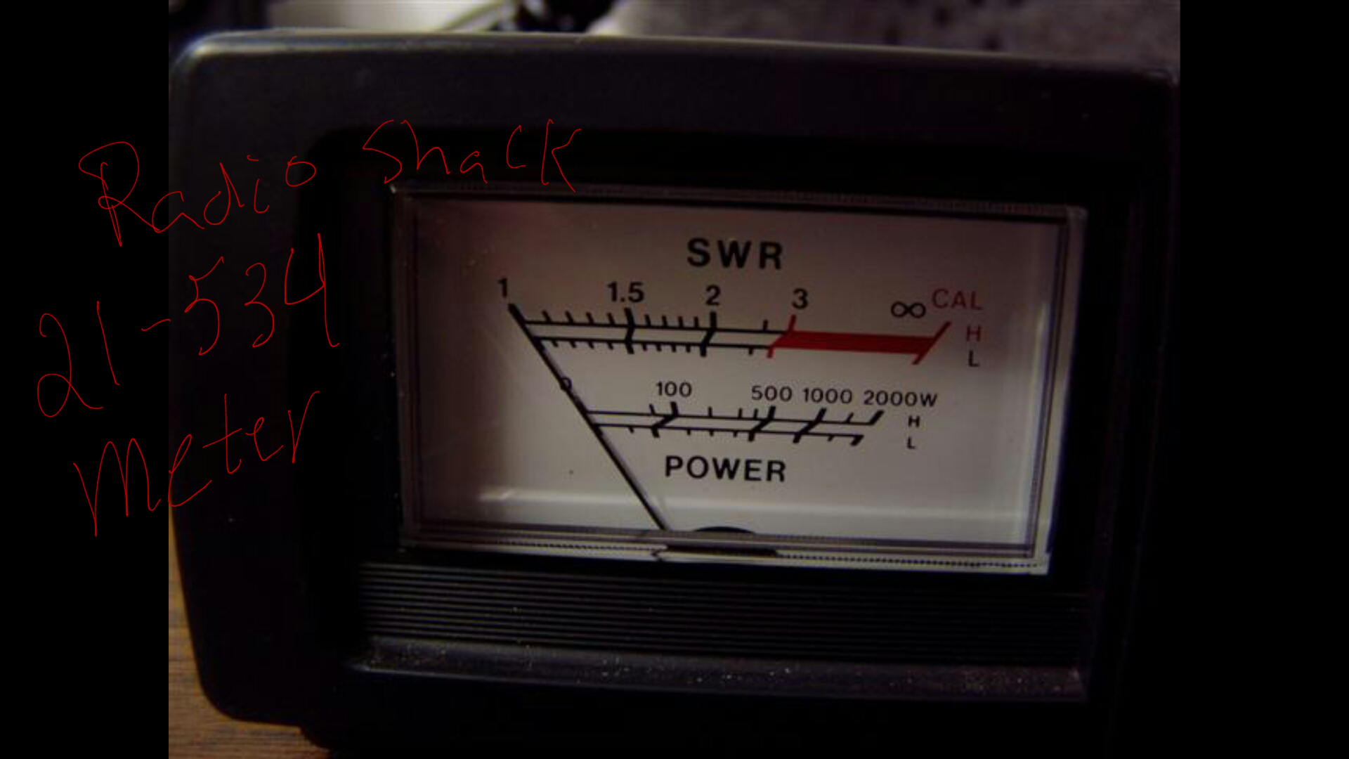

My 1st SWR/Power meter was a Radio Shack 21-534 SWR meter. Obviously I took the thing apart to see how it operates, and I learned a little bit from it. For some strange strange reason my brain told me to take the panel meter and take it apart and see how it works. After popping it open, loosing both of the microscopic positioning springs that hold the indicator up against natural forces, I learned that I made a mistake. So not wanting to mess with it anymore I put away until last week that I decided to dig it up and see if I can replace the panel meter since that's the only thing that was wrong with it.
Anyway, I have not been able to find out what rating meter they used for that SWR meter. I have tried a 100uA and its too small and a 1A and way too big. I almost wanted to use a resistor with the 100uA panel meter, but my readings will be off & I would not know what size resistor to use.
I have ordered a 250uA and 500uA meters but the good old government ran post office has lost them. I have tried to see if I can pull up schematics for that particular SWR meter, but there is not a schematic for that particular one. I have tried to match other schematics to it, but some components are always different in the meter compare to the schematics I been able to find online.
This SWR meter uses a very nice and large SWR bridge and not a microstrip.
Anyone have a clue what I can do to determine this information and get this thing back up and running?

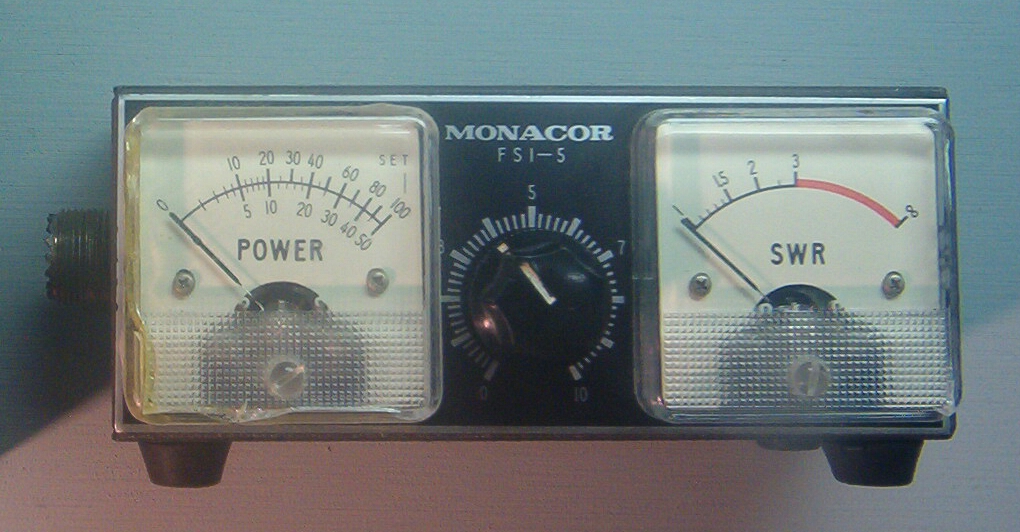

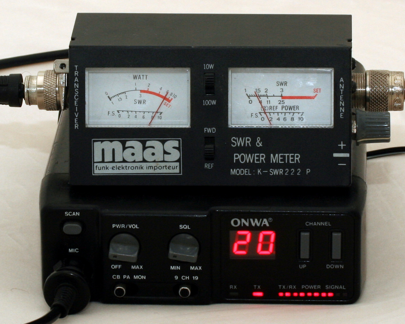

By the way, I have purchased a ton of other meters within the past few years and have tried to use one of those panel meters but the readings on those is a bit different than the on used in the Radio Shack ones. Please see attached pictures. For example, the number 3 for the SWR reading is directly in the middle in all my other meters compared to the Radio Shack one which is a bit towards the right.
