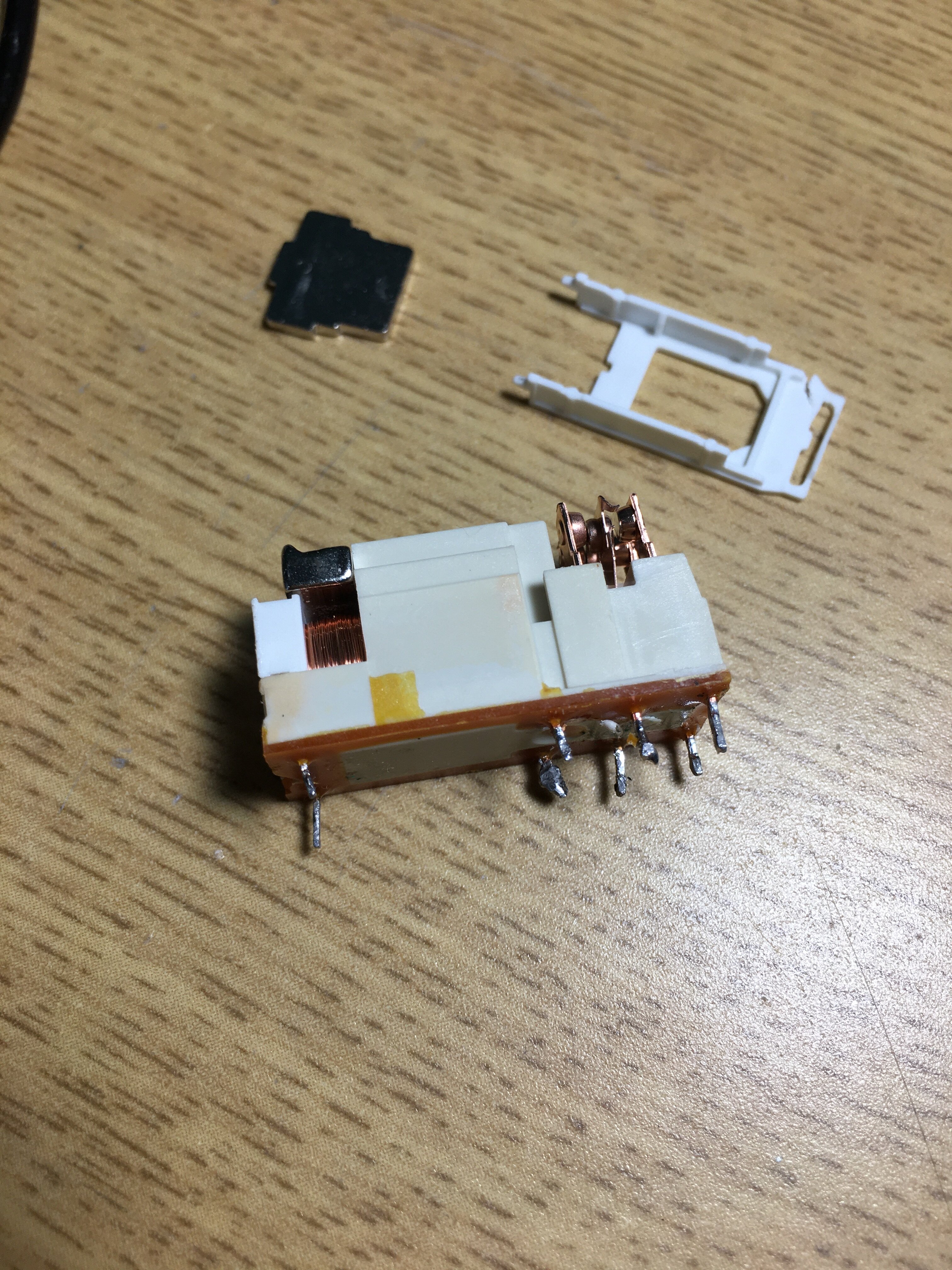

This is what I found inside.
The failure was it would not do anything when coil powered.
It worked last night but today when I tested prior to taking to roof, it would not activate. Rated at 8A

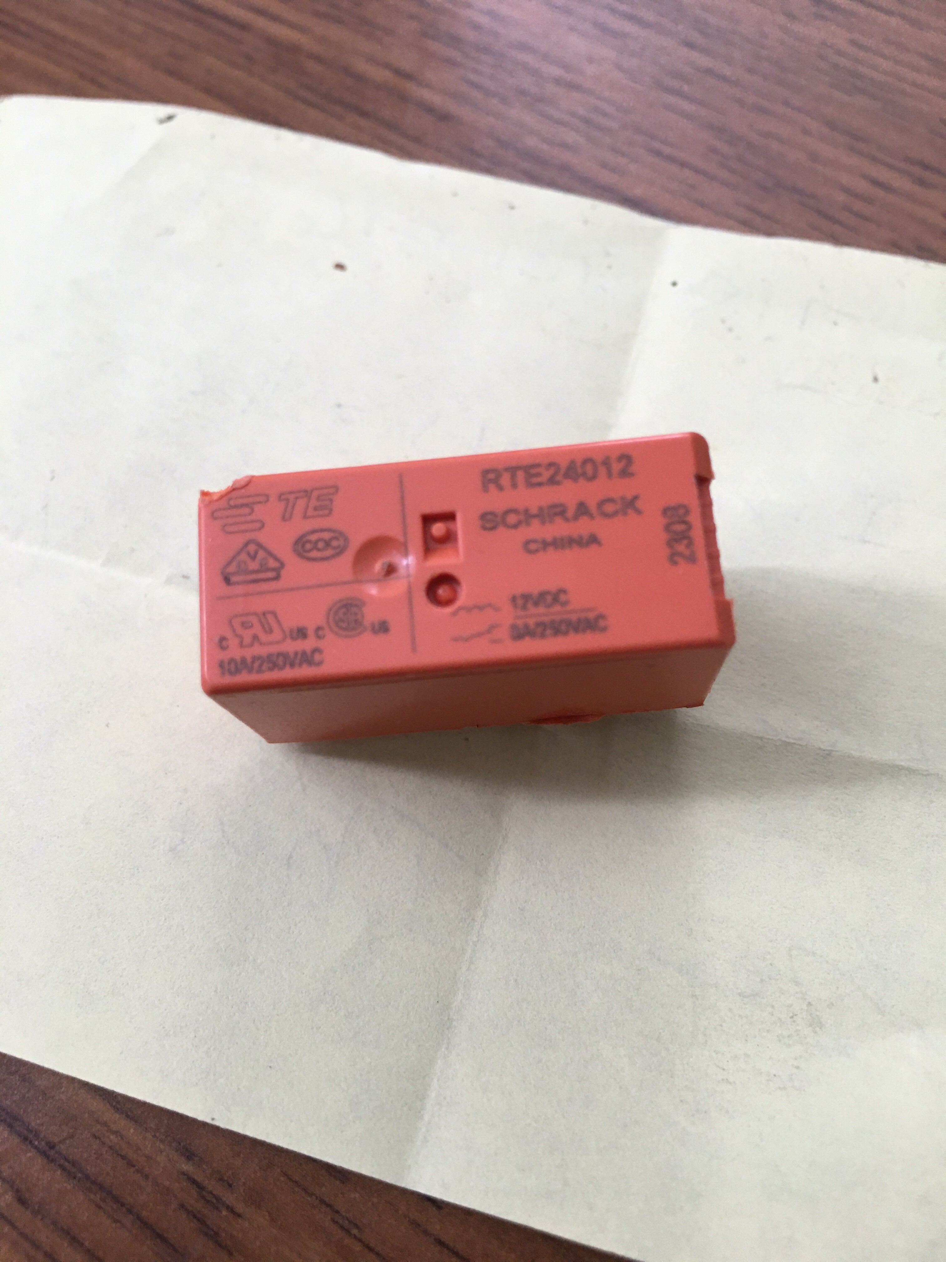

Can see color diff btwn the 2. The dark one I know is genuine. Light colored 1 I got from PRC

It's been my experience that these relays have a very low tolerance for heat while being soldered into the PC board. A little too much heat and it will melt the contact pin and shift it out of alignment enough to where it either does not make connection or makes one with a little extra resistance, causing heat which will eventually cause the contact to fail. They tend to test out perfectly on an ohmmeter, until after they've been soldered in. Very convenient...
We routinely clip away the unused pins from a DIP socket to match the hole pattern in the pc board. The socket serves to limit the heat stress on the pcb foils if the new relay fails down the line. The adhesive that holds the copper foil to the laminate will tolerate a finite number of heat cycles. Haven't had infant-mortality issues with DIP relays yet. Probably only a matter of time.

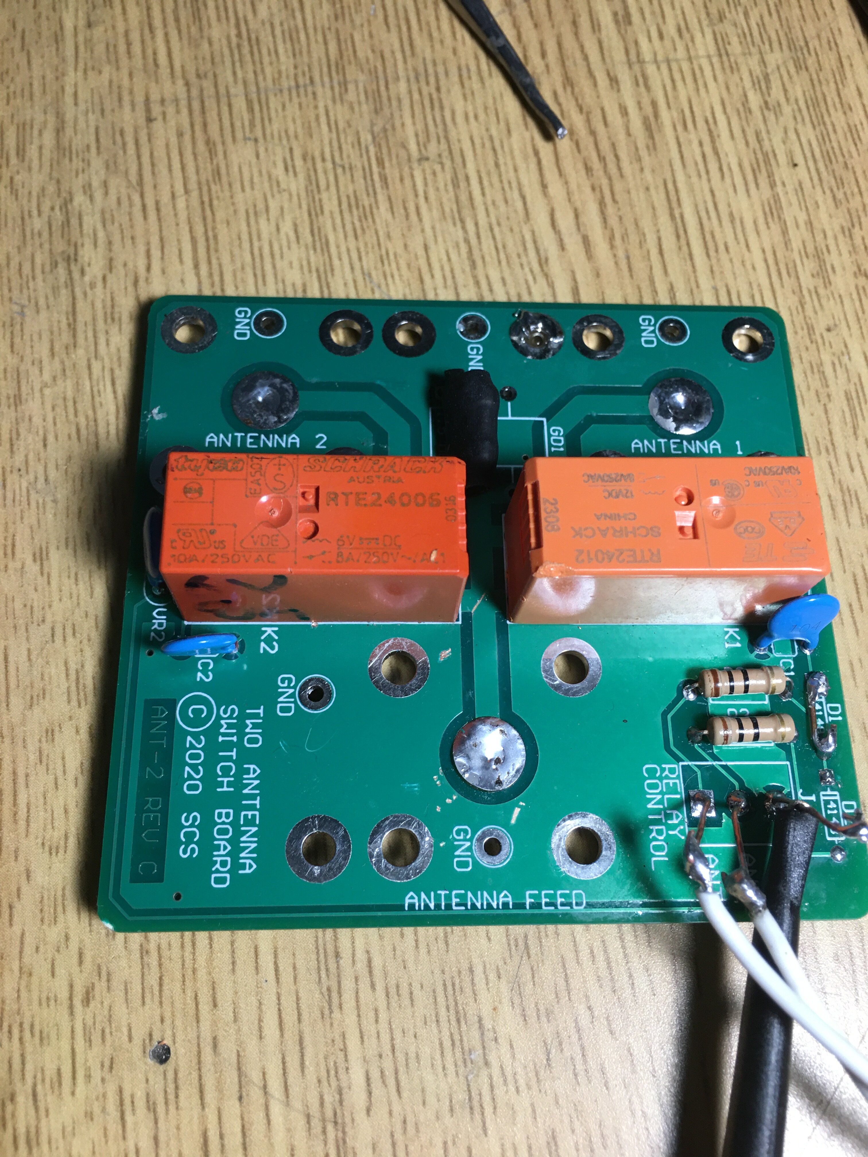

It was only 1 bad relay and never had a bad relay coil problem ever, that I can remember. My estimation of the total number of relays I purchased over my lifetime is somewhere 40-ish. Yet I learned something else about the factory relays mounted on the Preamp board. Specifically, the factory relay-pinout on the preamp board has the center pin(s) as common while the standard config that I usually see (like the Schracks or Omrons) has the end pin(s) common. So yeah, I had to remove the relay replacement I mounted (picture) before checking the pinouts. Mistakes happen and it's why I'm only an amateur but able to admit my error.
